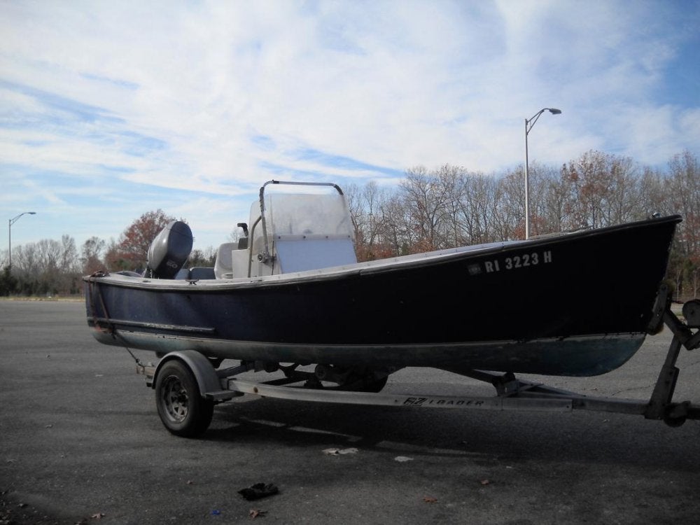

Hello i posted a few times that i was looking to buy 18' boat. Well i found one and brought it home. What i bought was a 79 Pointer made in Yarmouth Maine with a 2007 Yamaha 60hp four stroke. The floors have some soft spots so i decided to pull the console and remove a piece of the floor. So the foam is full of water and there seems to be no stringers in this hull. Should i remove all the wet foam and re foam with a new plywood deck?? What are some options maybe add some stringers?

Nice looking boat! Love the Pointers. If it was me, I'd definitely rip up the floor, pull out all that old, wet foam, clean up and repaint the bilge, and lay down a new floor. What is the existing floor supported by? You could 'glass in a pair of stringers, but she survived this long without them, sooooo. For the floor, some okoume or miranti plywood (5/8" or 3/4") 'glassed over would serve you well. And, you could stick some 2" closed cell foam insulation board to the bottom of the new floor using polyurethane insulation adhesive. Good luck and keep us posted!

Thanks for the kind words. The floor seems to be supported by the foam from what i can tell ???

RK thanks for the link on SOL. Eastporter i have read thru your build a few times..This is my first saltwater boat and i plan on chasing stripers and blues around salem sound. Question the floor seems to be supported by the closed cell foam that is water logged. There are no stringers supporting the floor.When i remove the wet foam what do i support the new floor with? Should i add a bilge drain plug to keep things dry?

A boat with no stringers seems peculiar. What longitudinal supports are there? If the Pointer was mine I'd cut the entire sole out, remove the old foam, put in three new stringers, and add closed cell foam (sheets) just like I did on mine. You can use DRY pressure treated wood with epoxy products. A lot of these boats have the scuppers too low- you might want to increase the stringer size and by doing so increase the sole height (3/4" ply is stiff and rugged for sole). Drill 2" scupper holes after installing new sole. Good luck and keep the photos coming. :D

Guys thanks for all the help so far. The transom seems solid so far but i need to dig out all the foam to get a good look. My plan is to continue cutting out the deck and remove the foam. Then i can decide if i will put new foam in or go with some stringers. This type of work is new to me so I'm a little un sure about doing stringers myself. Again thanks for all the help so far.

Goodchance great looking boat you did a beautiful job with the resto. I dug out some more foam today. There is no sign of any stringers just solid foam. The deck is sitting on top of the foam. Im working on the boat outside and after work so does not leave me much time to work. More wet foam man that shit stinks!

Ok so i made some progress i think. I dug out 16 trash bags of wet foam. Found a few broken stringers and wet also. So my plan is to remove the engine and cut out the transom. I drilled a few holes and found wet wood. I plan on replacing the stringers what type of wood should i use?
