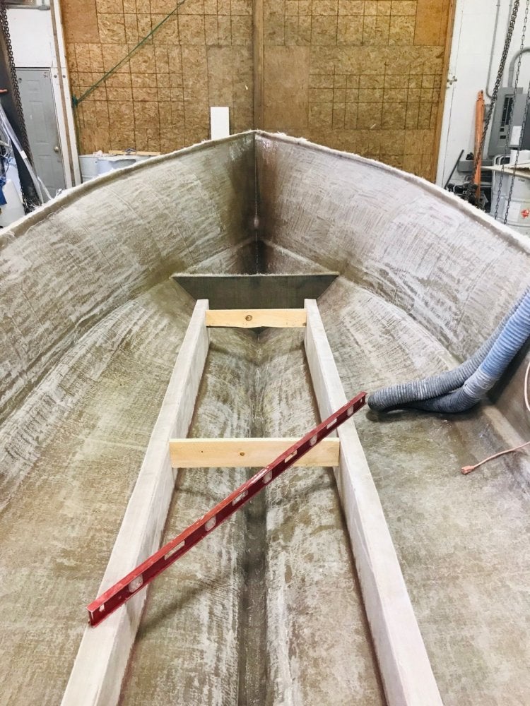

Great idea to go with an all composite build on this boat! Did the builder make those glass stringers or from a factory?
