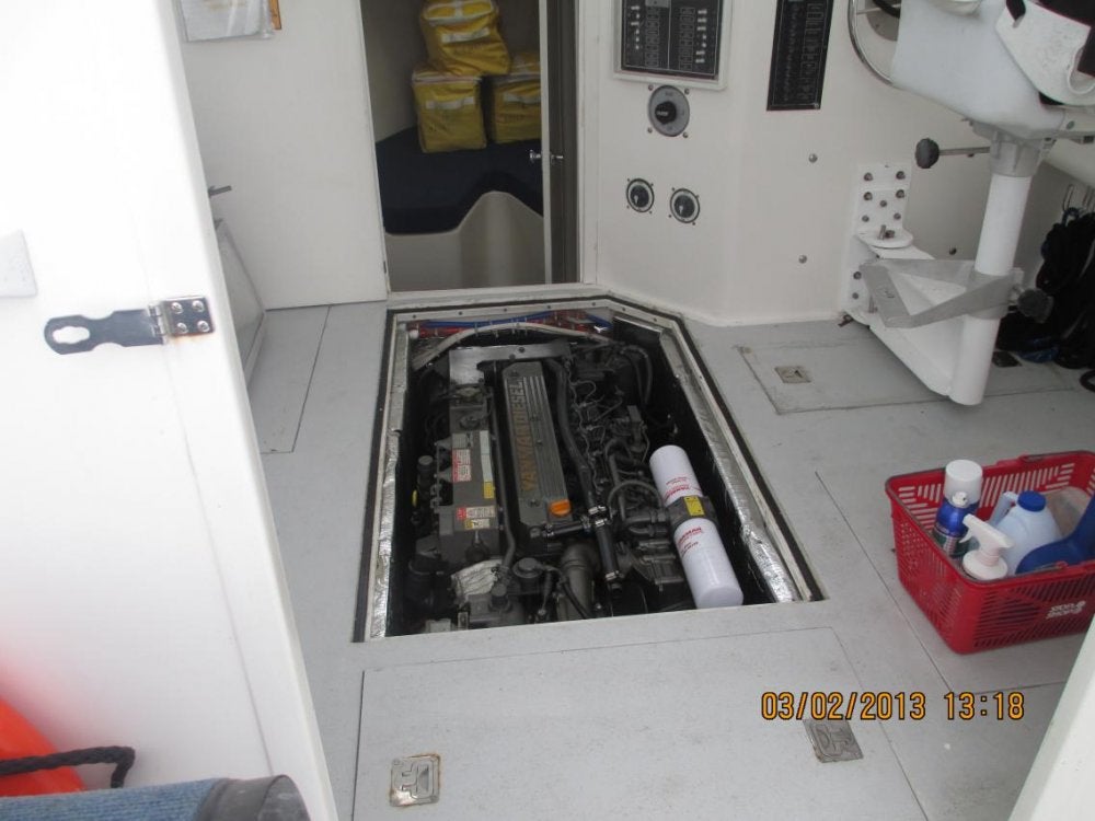

here's a few pics of 29 H&Hs
take note of the last pic of the JAKL. That is a 440 Yanmar "under the helm deck"

those 29' h&h's are some sexy bitches. God,Is that engine compartment as tight as it looks?

AS TIGHT AS IT LOOKS ! but there are hatches on both sides and the owner has Yanmar take care of the motor.
1500+ hours on it.
btw, the FPT NEF 6.7 is about 1-2 inches taller and a wisker wider than the Yanmar 440. The Cummins QSB another 1-2 inches taller than FPT.
