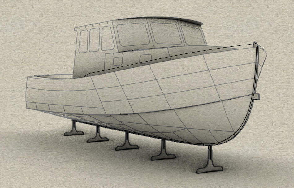

Well, after looking at a bunch of shitboxes and daily internet searching with not much to show for it. I decided to go with Jesse’s new 30‘ design and build one myself.
Jesse and I spoke many times, (and still do) and jumped from size to size attempting to check as many boxes as possible. I’d have to say, he could not have been better to deal with. he was patient and knowledgeable.

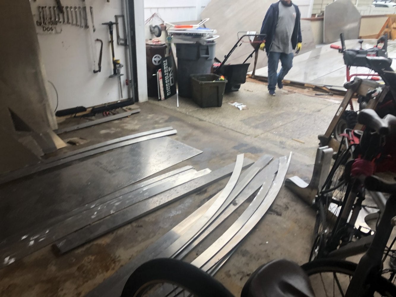

Dry fit the keel
Welded on flat stock to help keep it straight
