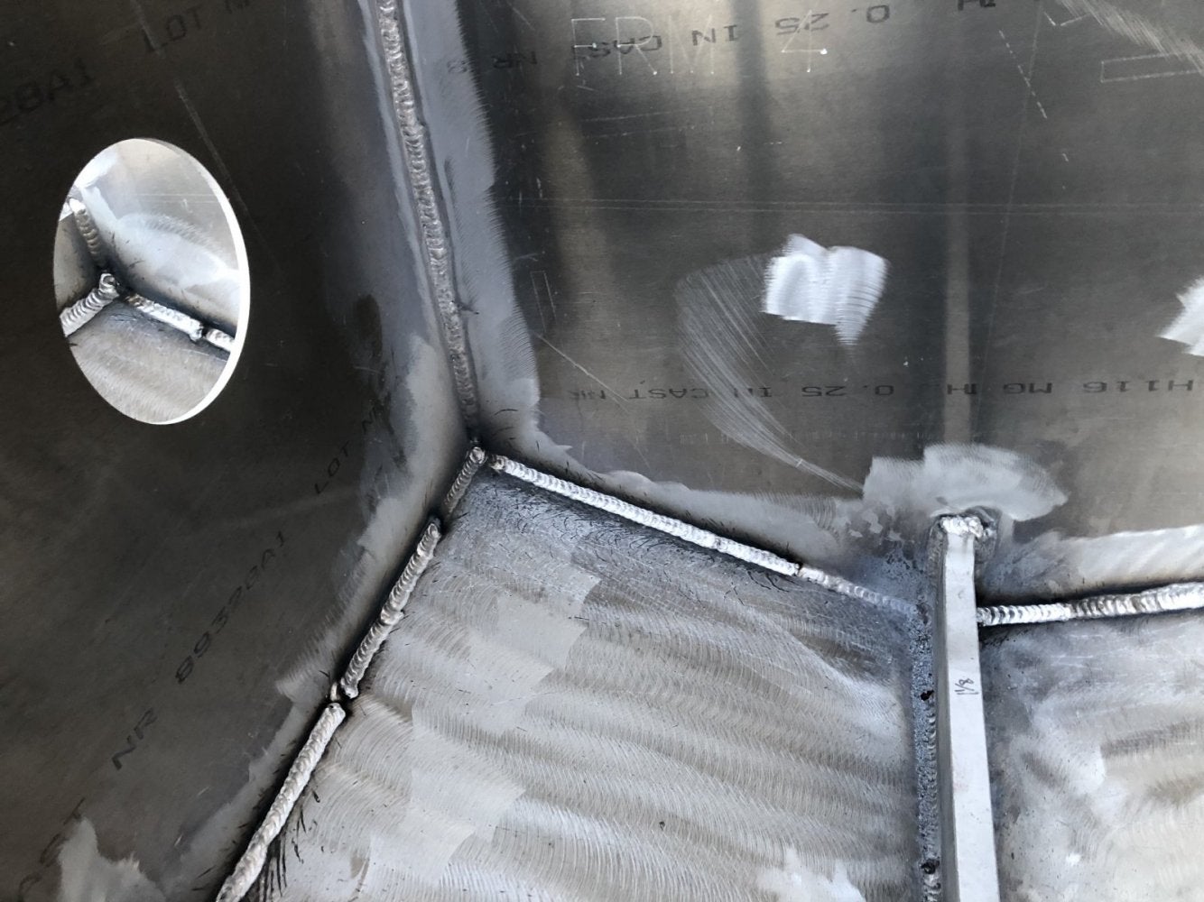

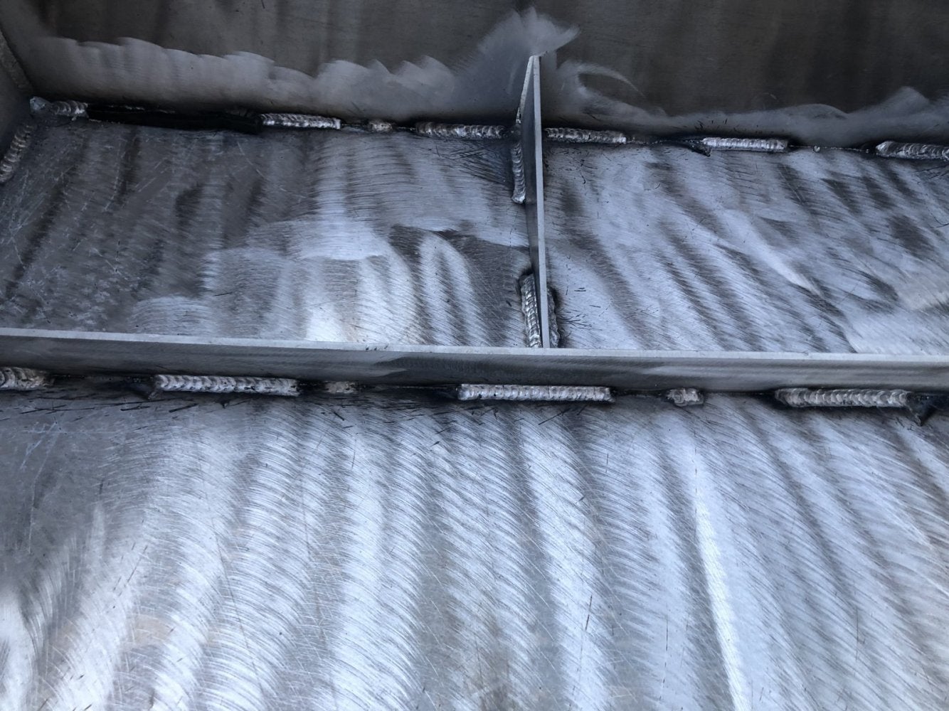

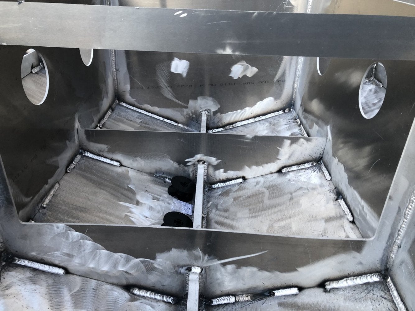

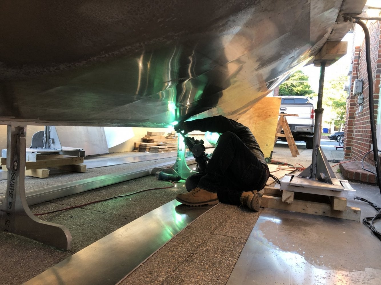

Well got the gun working right again and spent yesterday catching up on some production welding - it was like working on the sun - finished inside chine weld (for bottom plate), bulkhead weldEd aft-side, and started outside keel weld When it started to get a little breezy.
Some prep work to do today, after coffee, and hopefully some more skin By days end.

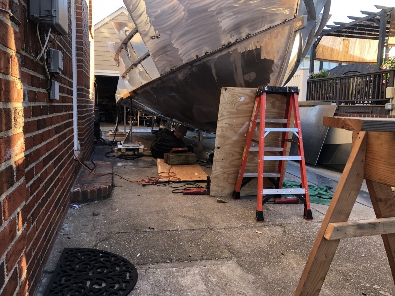

Ha. That’s funny and I can understand his pain… I wanted to start this in the winter or early spring, but, shit happens and here we are.
there was way more prep work today then I originally thought . So I got to the plate a bit late and a lot of tired… I am not Convinced that I can tweak it to where I want it…I just ran out of steam. It may have to come down and reset it tomorrow or Monday with fresh eyes and energy. For now it’s tacked and secured

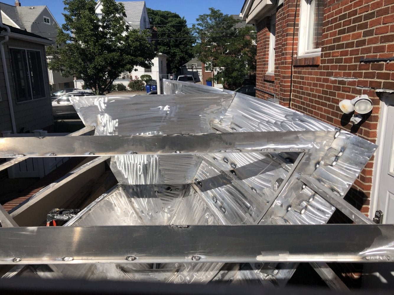

another day, extraordinarily hot, had to pace myself and be mindful to drink a lot and take a bunch of breaks.
After a day of monotonous welding, I decided to pull the side sheet out from under the jack stands to prep it for tomorrow. Promised myself no matter what, I’d lay it back down until tomorrow and start fresh then. I put it almost all the way up just to see if I needed to adjust the hooks.
looks good for side skin manana…working alone with a mechanical advantage…
