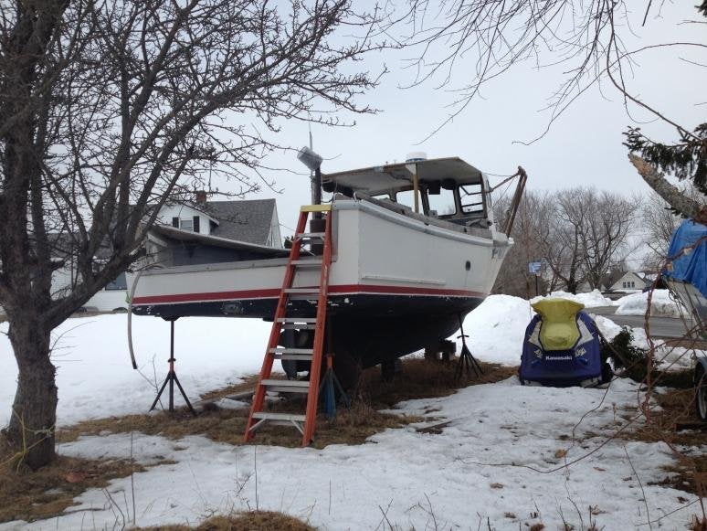

Hey everyone, Im getting the new boat shipped soon and the mover needs to know the approximate weight and the beam of the boat. She is a 1986 BHM 31 . She is built as a lobster boat with out a lot of bells and whistles or extra bullshit. TD-506 gear and a 220 isuzu. Anyone know what she may weigh??? My guess was about 15,000 but I am not sure. Any help would be great, Also need to know the beam. I think its like 11' 10". thanks in advance fellas.
