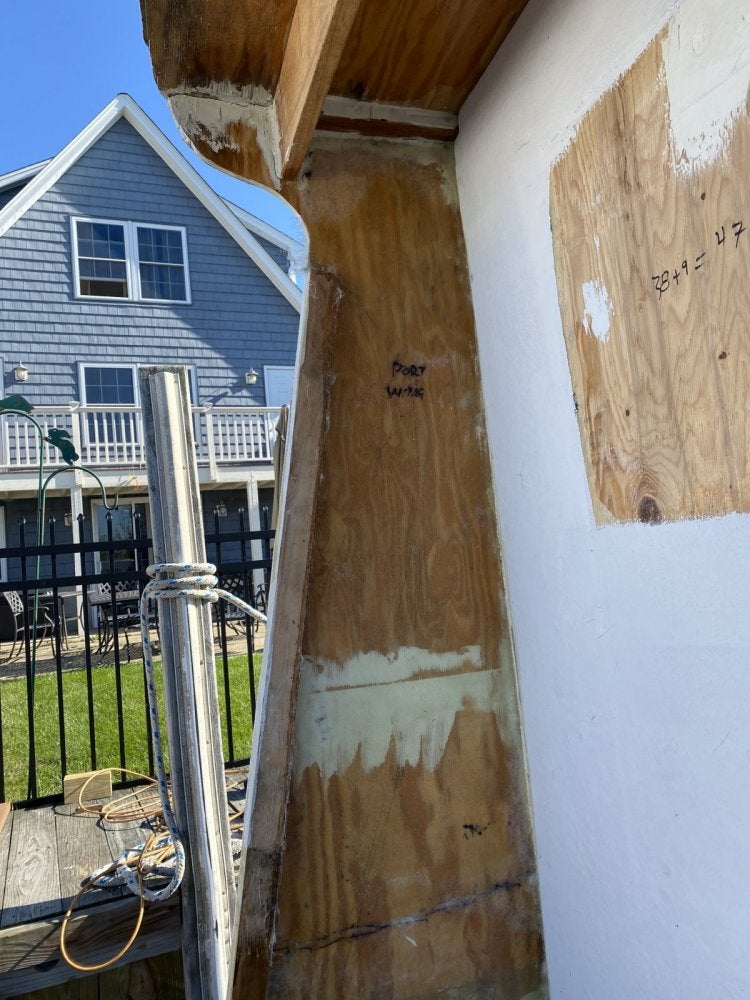

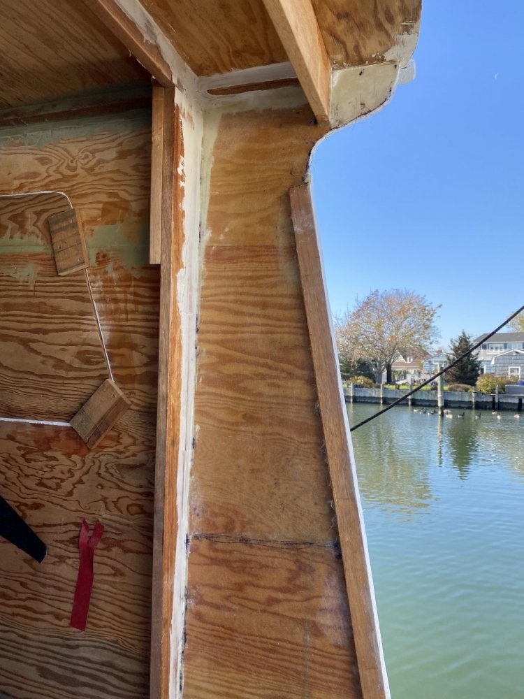

Got the wings done on the cabin today and got the overhand hot coated. Some light sanding tomr and wipe down for some gelcoat over the weekend.
I did the math for the door to match the starboard and should start it over the weekend. Some mahogany, a piece of 1/2 plywood and a little starboard as a glide and track.

Took some time and built the door for the back of the house. Looks like it will do the job! Now just some filler, glass and gelcoat

Door glassin and 2nd run of gelcoat on house and wings. I forgot how heavy a mahogany door was.

Framing is a pia, I forgot about that. Ohh well c’est la vie! Thought about a big window, scratch that! Three across the back.
