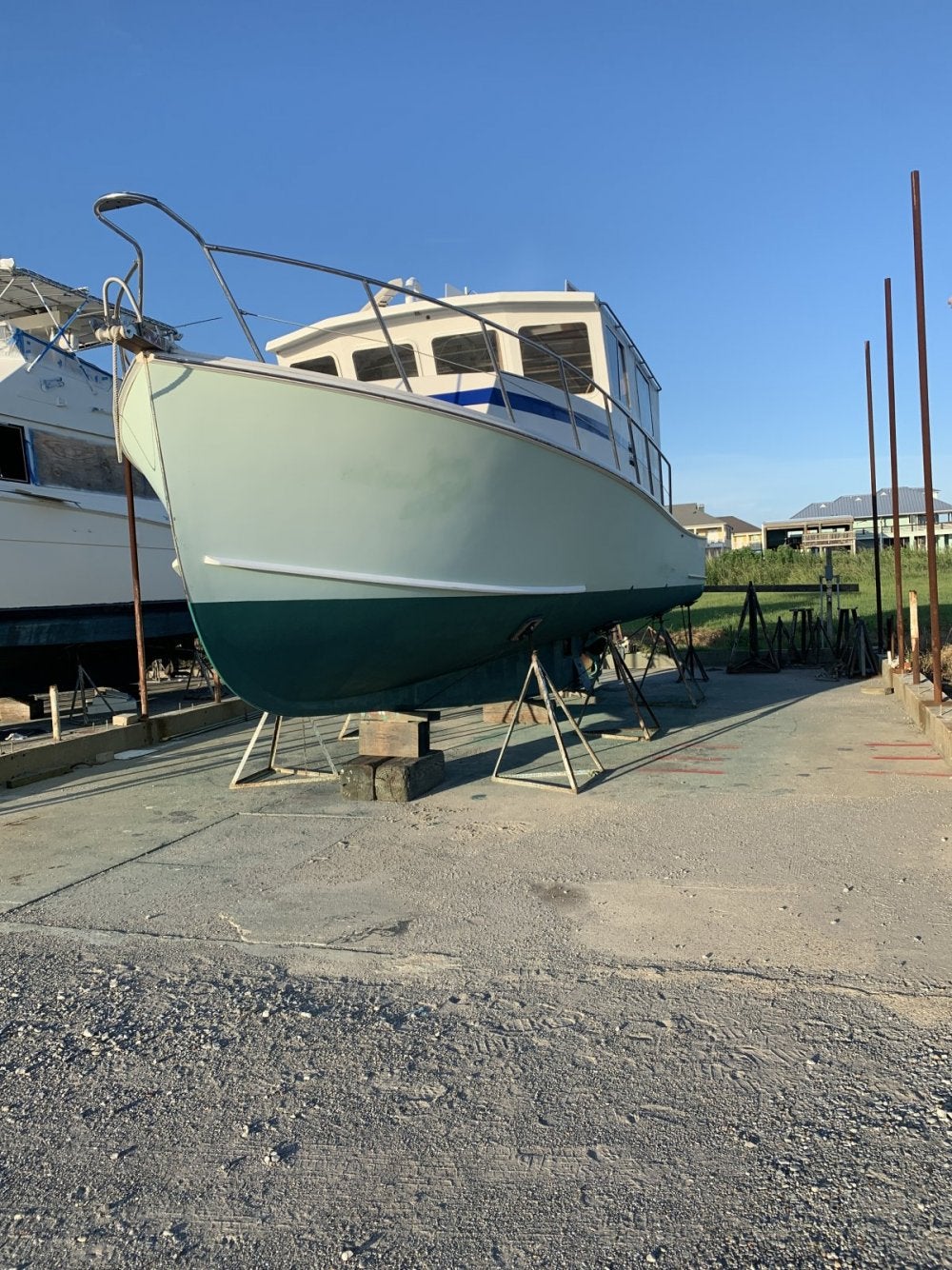

Well Y’all,
It was an introductory post. These boats are certainly uncommon in the Gulf of Mexico- they’re made for the ocean - which is my destination.
I didn’t join this blog to sell my boat. BUT, with the wonders of modern medicine, that can change in a day.
My health is forcing me to sell. I haven’t listed her yet. I’m quite upset, we were successful treasure divers off this boat- she’s a “Million Dollar Boat”! A full rebuild was in progress.
if you know anyone that’s interested - I’m [email protected]
Thanks and calm seas to All!
Avery
Sin_or_swim
Feb 25, 2015
76
54
Bermuda
Welcome! I have the same hull 1991. What do you have in her for power? I would love to see more pictures of your setup!
Jun 25, 2021
6
13
Avery
This is a fun site!
I have an intermediate bearing which makes alignment a challenge. Boat builder did not put engine jack screw mounts. Also no engine room ventilation! No wonder the 1st engined overheated! Also, in a low tide while rudder was removed, the skeg extension broke off. I replaced with stainless steel which seems to be ok as we hit a pile of rip rap and it’s still there. Finished interior in Louisiana reclaimed barn cypress. Cut windows down, cut off decaying hard top. Planning on alum framed awning
8v92 TTI 650 hp. Cruised at 16knts at 1800 rpm. Just cut new wheel down to increase rpms -
