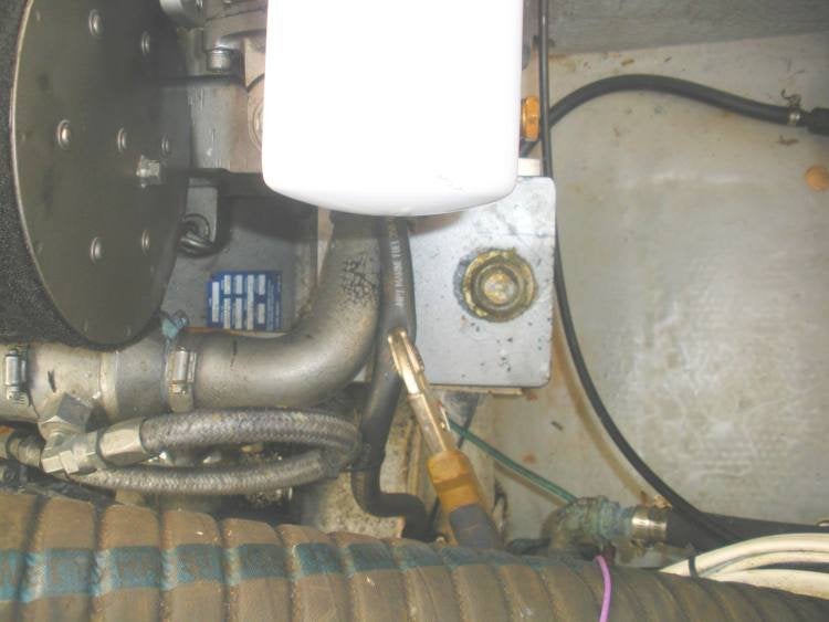

Before adding acid you have to remove all zincs. Zincs will quickly waste in acid and will deplete it unnecessarily. So remove the brass cap, unscrew the zinc and reinstall the brass cap.
Also pinch the prop shaft log cooling hose with a pair of vice grips or similar. This is shown in the third picture.
