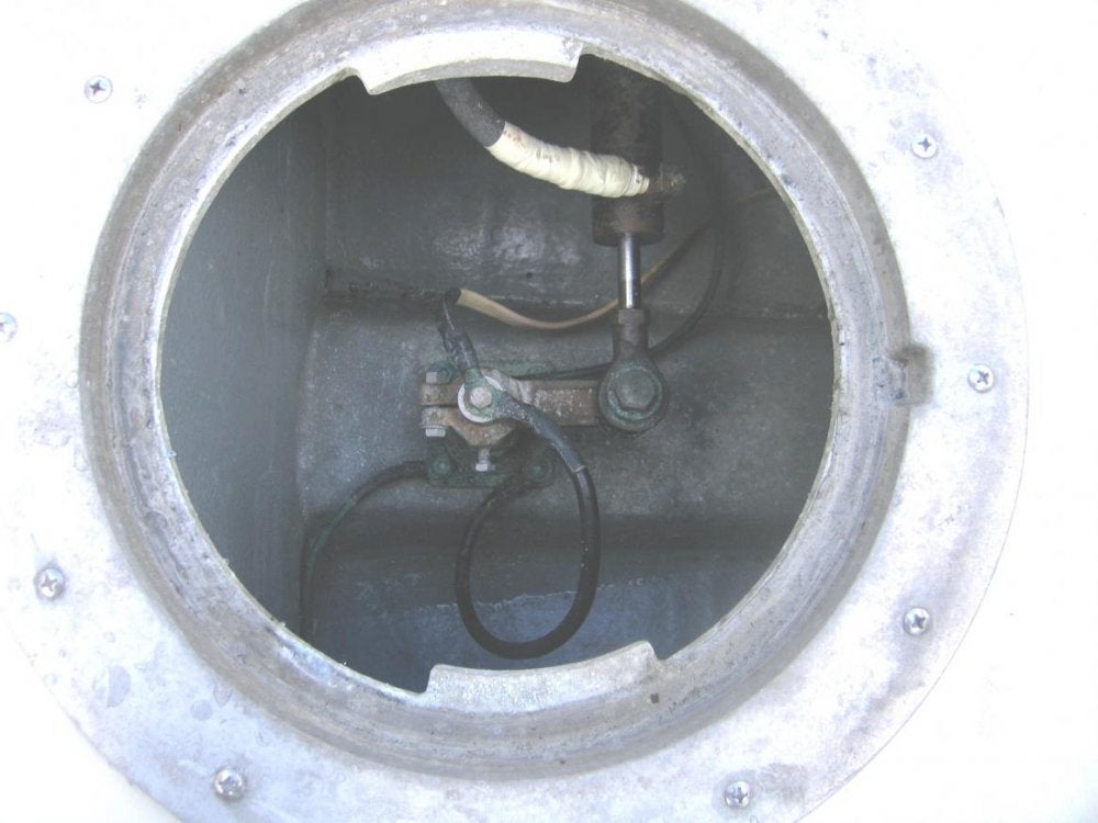

There were some post on some bonding system that look pretty good. The one thing I noticed was that no one place a jumper bonding wire from the rudder stuffing box to the rudder. The jumper adds more protection to your system. Should your rudder zinc. The jumper is needed because the flax packing isolates the rudder from the system.
