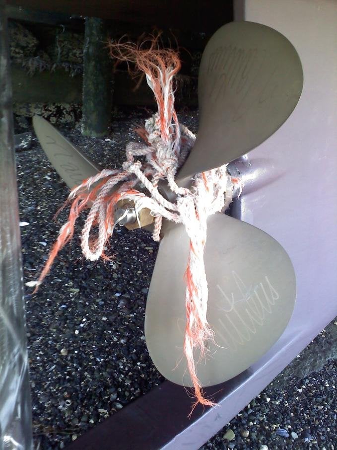

True story: Myself and another were heading to a race in somewhat turbulent weather, seas were in the 2-4 range and the wind was howling just a wee bit (sustained 20's) I in my NB36 and he in his CB 34, both have the same power - 410 Sisu and both with comparable speeds. Both of us cruise at 25 mph but only one of us was able to do it that day, because the terrible pounding made them slack back to around 17-18, and even at that reduced speed it was still bouncing at a fairly good clip. Up ahead the nose was just raising and lowering with the roll of the waves, no jostling, no banging, just a sweet soft ride.
Later on that day when I decided to continue East while the rest of the fleet tucked tail and ran back West, I found myself in increasingly worse weather with seas creeping up steadily around the 10 foot mark, winds now pounding the side curtains at 30 mph I too did have to throttle back quite a bit. But not due to any adverse effects of pounding, rather I was running with the waves but I was going much faster than they were and the six year old, on her first real big boating adventure, wasn't too keen on the pitch poling sensation of cresting the wave and plunging down the other side. Throttled back and it was surfing from there, only jostling was from the random rogue wave that bashed against the transom and rained down a bit of salty sunshine upon us.
I can't comment on the ride of a skeg built boat in those conditions because no one wanted to come and play, so we have no data. It was an awesome trip and I'd do it again in a heart beat. Only this time I would check my propeller and take the damn rope out!
