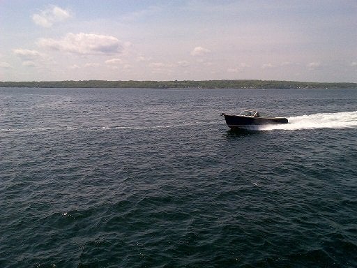

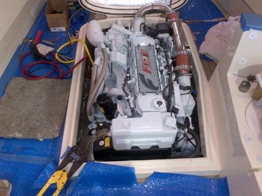

Here is a recent Hinckley Yacht repower where a Volvo D6 435 was replaced with an FPT NEF 560, top speed before was 35.5 knots, top speed after is 42 knots! Customer likes to cruise 36 knots and tow his kids in tubes and on ski's.
Specs:
29' Hinckley Runabout
HJ 292 Jet w/ 22kW impeller
ZF 280-1 - 1.139:1 ratio
FPT NEF 560 - 560 Mhp @ 3000 rpm
WOT speed - 41 knots against tide, 42 knots w/ tide
Cruise speed - 36 knots @ 2750 rpm.

Peter- When will the 6.7 be available to purchase in a A2 commercial 500hp version? Will that be the new NEF 570? Thanks
Available for purchase now, have been available since March. Feel free to order any time. Yes, it is the NEF 570 turned down to 500 Mhp, I tested it on this vessel also and we maintained 38 knots at WOT, but the impeller was oversized for the power of course.

Isn't this the Downeast Boat Forum? It is a downeast boat and has been recognized as the Downeast Production Boat of the year in 2012. Just because it has Jet drive doesn't mean that it doesn't have a wheel for controlling steering (see pictures), in fact in high speed mode everything is done with the wheel, unless you meant prop, in which case they also do build if requested. They have some propeller boats in SW Harbor and Portsmouth RI.
