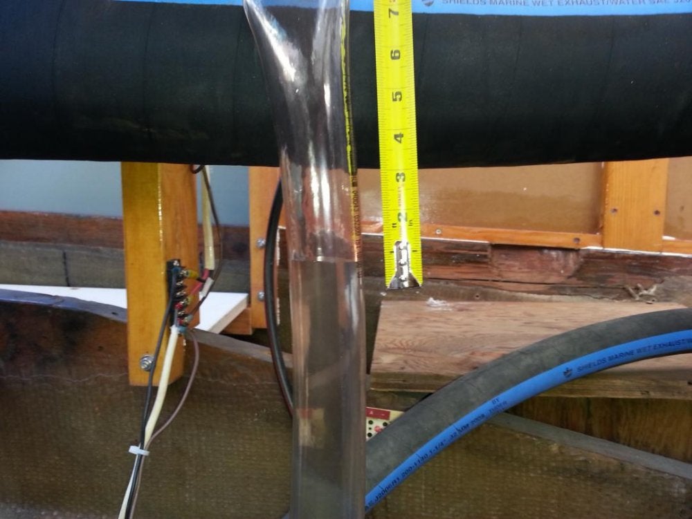

I have twin 4" exhausts, totally open, very little rise to the risers, been that way for 42 years, apparently no problems as the engine is still belching along but no sane person today would recommend doing this. I would recommend looking at the rise between the exhaust at the transom and the spillover at the engine and make sure that it has the recommended 12" or more, a surge tube and/or an inline axial water drop muffler would likely be good choices to add to mitigate backflow. Can't see why the rubber flap couldn't be of some help, "most of the time," pretty good bang for the buck as part of the system. I underline system as that is what is important, how the whole system works together. I would not sink and engine exhaust 12" below the waterline and expect the flap to keep it safe. Neither would any one of the other ideas alone be bullet proof, this is a good place for redundancy, several pieces that each alone are good and complementary, and all together, much better.
