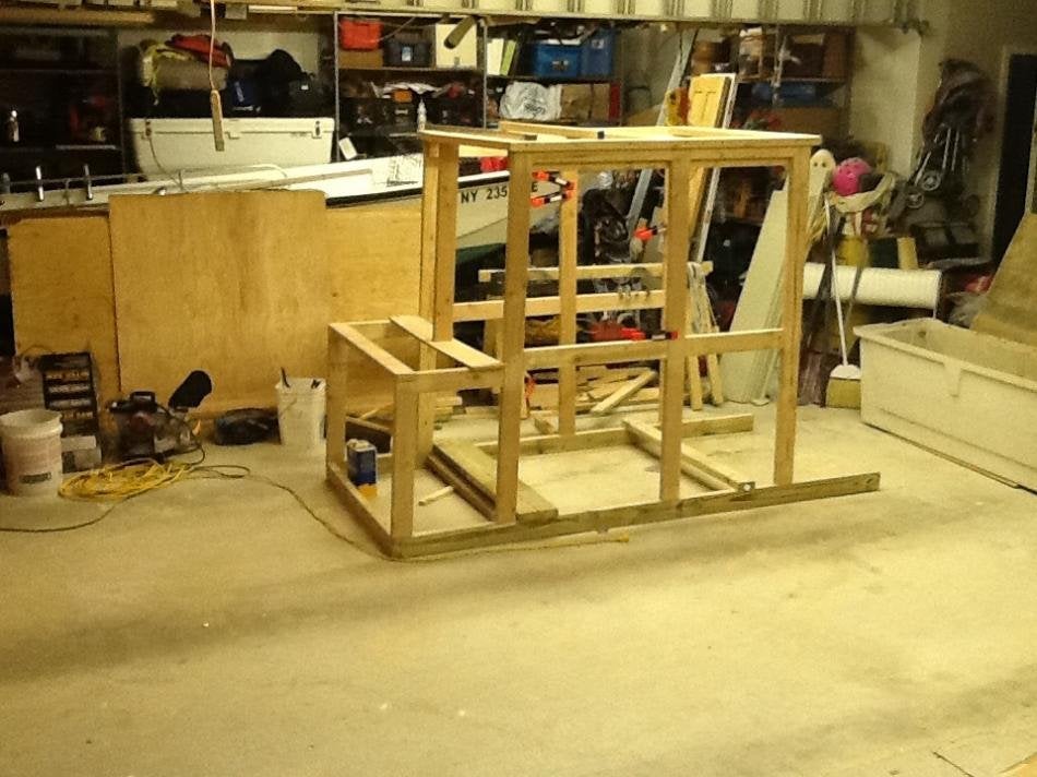

I am building a new wheelhouse out of plywood and I want to glass the exterior
1 Does anyone have any advice as to what mat I should use, some one recommended that I use 1 1/2 oz and do two coats
2 what is an eay way to mix the polyester resin with hardener, I never get it right And it kicks too fast, what would be a good ratio if I want a good half hour to 45 minutes at about 55-60 degrees outside to roll the resin on the house then soak the mat for first coat
I guess I would cut the windows out first and have all my pieces of mat ready to go
The house is 5' 10" tall 6' 6" Long 47" wide the trunk cabin, for lack of a better term is cut in 18" to meet the windows and is 32" high
How much resin/mat do I need for two coats and what is the best ratio to mix the resin to hardener.
The framing is almost done and I would like to sheath and glass this weekend
Thanks

A bit of angle on the sides of the house might make it look oh so much better, a little radius too if you can swing it. You should be able to spring your panels to get that, just shim the inside bracing. Are you going to be removing the brace work that you have there in your photo? You can save quite a bit of weight and get some additional space too if you do.

oh, i didnt mean square /square, the garage floor is pitched slightly forward
and the box in front of the house as well as the windows are pitched 2 degrees as it sits --the only thing i didnt do is put a cambre in the roof-(above my paygrade) and taper the sides. the house should(?) fit
right over the combings
i will have a better idea how it looks when i get it up on the boat,
hey-i get it------life's too short for an ugly boat!

started sheathing last night, i am concerned that the panels will warp if i do them piece by piece, if i glass it while it is on the boat will it be much more difficult to do, the thing is beginning to pack some weight
jerseysportfisher
Feb 13, 2012
1,181
149
Communist part of NJ
Bertram 33SF
if you want to keep weight down, which indeed one would, looks like a small house for a small boat, it will increase the rocking momentum. Use it as a male plug, sheeth with divinycell, glass over the outside, pop off the plug glass inside. wala, light wieght strong house

no, no, no it's going on a 24' x 9' work boat, (Clam Boat), flat deck almost like a barge.
i will send a pic when i pull the cover, i sold the duffy and i needed a project
