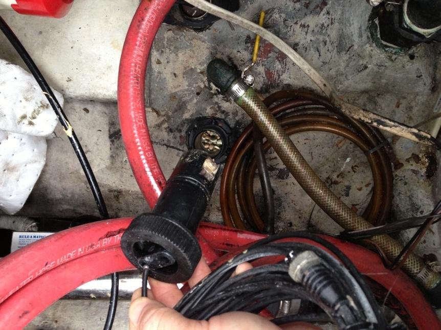

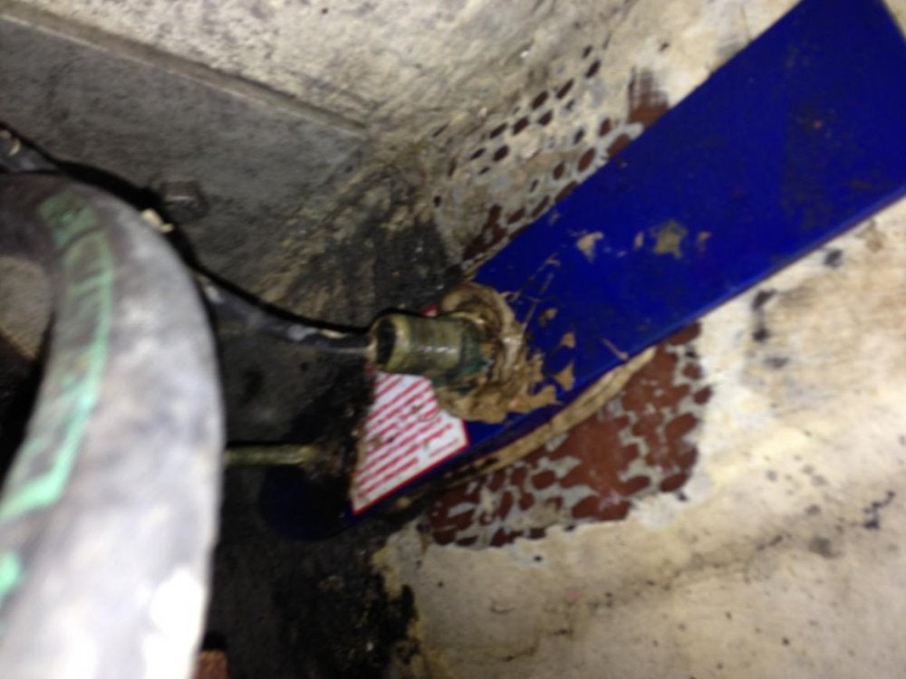

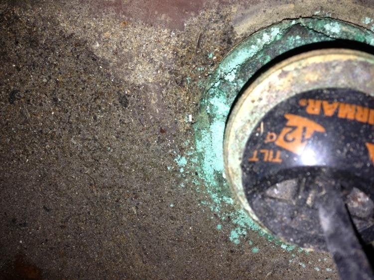

I have a C120W and C90W hooked up to a Airmar B60 transducer. I also have an old Furuno FCV600L. bought boat with this package. The Furuno was not working last season and i cant identify what the transducer is. So my question is do i get a 3rd c series display(i like having FF on its own screen) or do i replace the furuno and if i do can i use the old transducer here are some pics of what i have. first pic is ducer that furuno is hooked up to second pic is a ducer that has a wheel that was not hooked up, i assume this was a speed/temp ducer for the furuno. and last pic is the airmar b60 for the raymarine.

What Transducer do you all recommend? I hate having all these thru hulls that arent being used anymore. I wish i could use an existing hole or maybe a in hull transducer. i counted 5 total 2 being used. 2 llok like old dyteck temperature thruhulls and the other one is the plastic thru hull with the wheel.

alright i think i am going to go with the FCV 587 and i think i am just going to widen that hole i have for the old plastic speed/temp transducer and go with a b164 1k w 12* or 0*. depending on hull measurement. i think the one hooked to raymarine is 12*. Anyway thoughts on that?

Hey Lou,
If there already is a 12 degree B60, then the B164 12 degree is the spot on replacement. If you or someone has a digital protractor at the yard, it'd be best to still verify it's within the 8 to 16 degree range which would suit the 12 degree sensor. Good luck!
