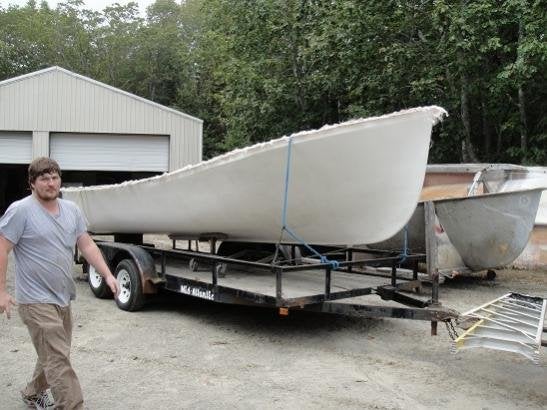

We purchased a set of the original 23' Seaway molds last summer with 2 tops one center console and the other with a lobster boat style top. Decided to build the lobster top to see what it looked like and if anyone liked it and if we could maybe sell it.
My plan is to finish it in a simple rolled gelcoat finish (Carolina Skiff style) to keep the costs down. Also changed the name from a 23' Seaway to the East Coast 23'

I would like to take a look at one. Is there a deckplate mold for the center console as well? Is that the only boat you have together?

Looks like a winner to me. The price I saw on Craigslist seemed very reasonable and a good value. Can you give us some details on the layup with photos? I wonder what kind of mold release you use. Thanks for posting.
This is the first one, I'm not quite sure what you mean by a deckplate mold...I think your talking the horse shoe mold for the forward deck and wash rails. We have that and 3 different console molds.
