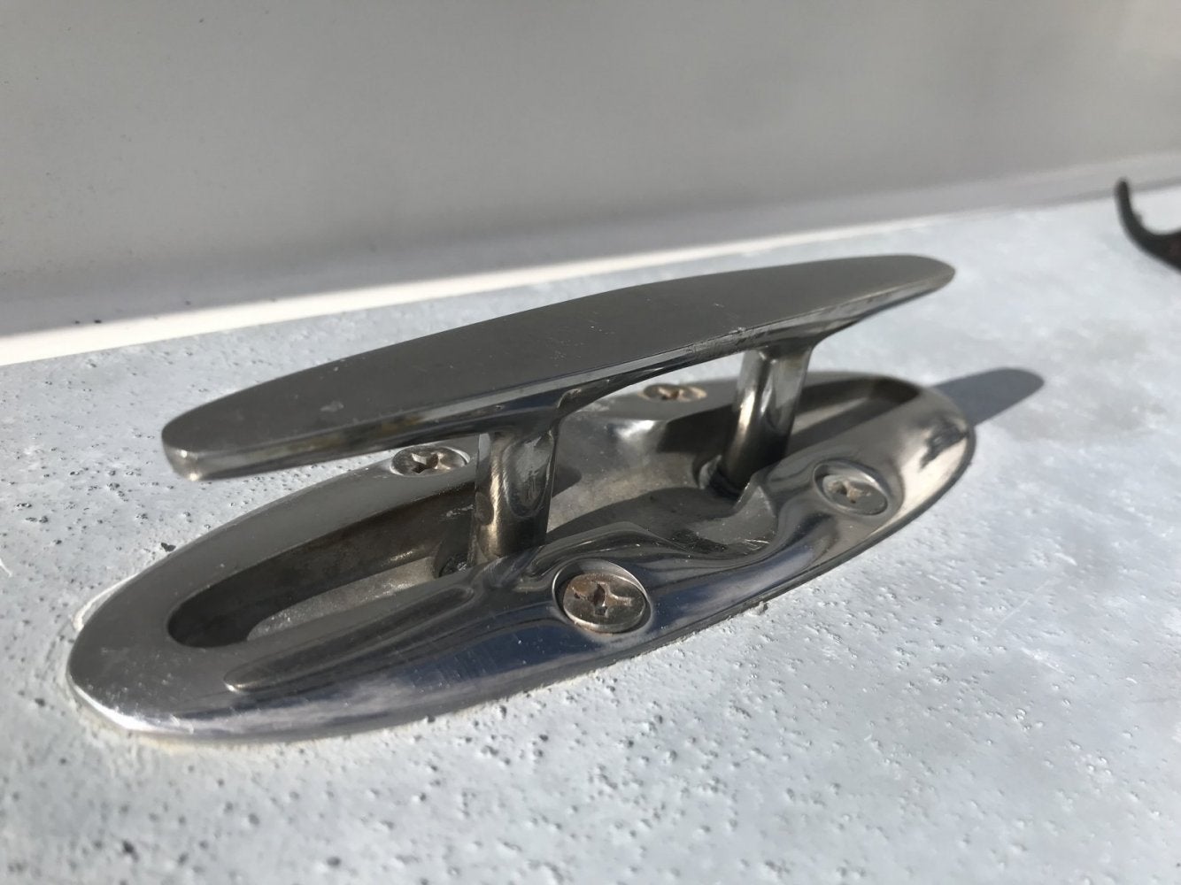

I had the same problem with similar pop up cleats, new, not installed yet. Careful inspection, I found them binding at the top edge, not the mechanism below. Some clearancing with a flap wheel solved it. B528C180-9BCD-4499-90F2-4C48A762952A.jpeg
Samp
Feb 16, 2015
270
263
AJ28
I had the same problem with similar pop up cleats, new, not installed yet. Careful inspection, I found them binding at the top edge, not the mechanism below. Some clearancing with a flap wheel solved it. View attachment 136782
No kidding? I’ll give ‘em a proper flapping tomorrow. Thx!
