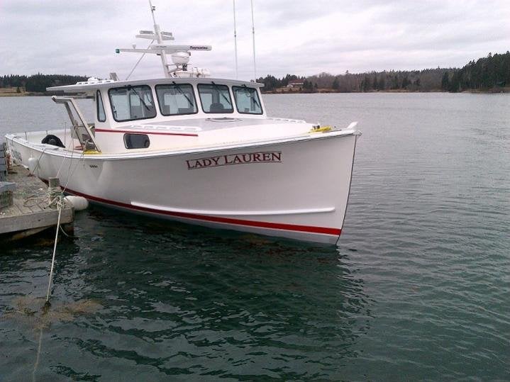

New 38' Calvin Beal w/ FPT C90 550 Launched in Bass Harbor ME
Just wanted to put up another successful new 38' Calvin Beal build with FPT C90 620 rated at 550 Mhp @ 2530 rpm.
Specs:
38' Calvin Beal - SW Boatworks (Stewart Workman)
Owner - Matt Davis
Boat Name is F/V "Lady Lauren"
FPT engine dealer - James Rich Boatyard (Jamie Thurlow) Bass Harbor ME.
Finished by Mike Light - Light Fiberglass of Corea Maine
Engine - FPT C90 rated at 550 Mhp @ 2530 rpm
Gear - Twin Disc 2.5:1 w/ live PTO
Wheel - 32" x 34" w/ slight cup Nautilus (I think)
Speed:
Cruise - 2250 rpm = 21.5 knots
WOT - 2530 rpm = 23 knots
Very nice boat, Matt was happy with how smooth the ride was and the performance of the engine, he felt like the engine wasn't even working hard to push the boat was his statement. He liked the fact that he can cruise 19 knots burning around 17.5 gph in a big boat. We all agree that with some lifting rails to make use of the spray that this boat could be a 24+ knot boat and would improve hull efficiency greatly.
Thank you Jamie Thurlow and Matt Davis for your business!
FPTMarineDiesel
Jan 21, 2013
770
268
Waldoboro Maine
Peter- Great pictures of a nice boat. At 23 knots wide open, what was the load% and fuel burn? Glad to see the FPT's performing good.
Hello Powder, the engine was 100% loaded and the fuel consumption was 26-27 gph at 23 knots.
The boat isn't really lifting quite right without the lifting rails, it is throwing a lot of water, if some rails are put on, it will lift the hull and create a lot less drag and the load and fuel consumption will come down at all speeds. Most of the 38' CB's I have ever seen have the lifting rails starting just above the water line from around the hauler area back about 12-14' along the hull.
At a good cruise speed he is 65% loaded at 20 knots and burning around 18-18.5 gph.
