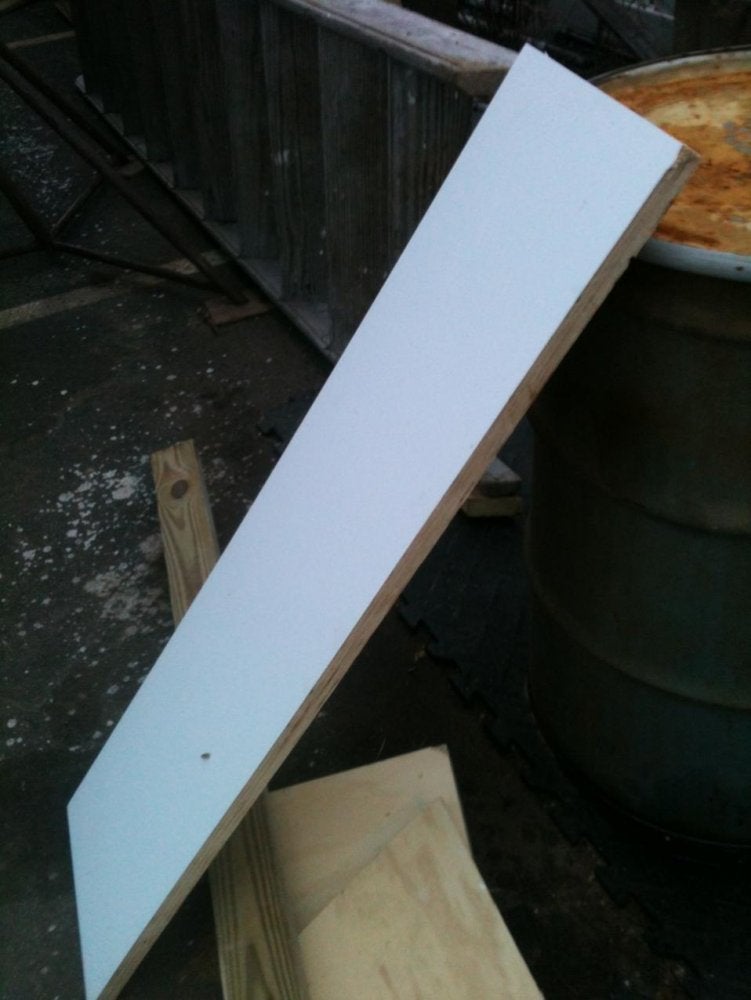

talked to wayne the other day.. the cabinet maker who built the 35 duffy..he said he and did this on his boat and this 50? duffy was just done in the hingham shipyard using this plywood..they get this prelaminated plywood from new england plywood and use the laminated side as the under side instead of coating it with resin.. maybe some of you guys have already used this method.. not sure, but thought it was cool

I saw this stuff back at keith otis's place O.M.E...he would blind fasten or sand and glass the back side....nice but heavy

I believe it is called whiteboard and Maine Coast Lumber carries it. Quite a bit of my interior is built with it. Today I picked up my 3/4 " Coosa board for my decks.
This picture looks a awful lot like melamine board...i think thats how its spelled...
