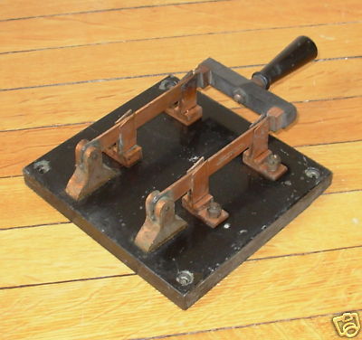

After the "slight mishap" with my own switch for the electric hauler, I had ideas of using one of these in its pace...
But I figured I'd lose so much time saying "BZZZZZZZZT" whenever I threw it that I wouldn't have time to fish so I just replaced it and put a generous helping of dielectric grease to it.
6,412
4,803
You ought to have a couple of bolts sticking out of your neck with that switch!
