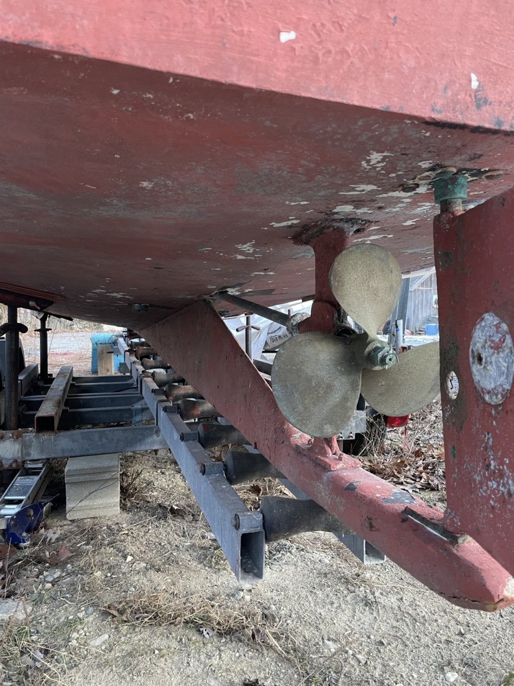

Hypothetically speaking, what's the thought of dropping a 42p, 240hp Volvo in my 23 seaway? Right now it has a 55hp Perkins, unknown gear ratio(definitely not 1:1 though) and a 14x10 prop and makes about 12knots. There was never a tachometer on the boat so I have no idea what the engine was turning to make that speed. I'm picking up a 1:1 ratio 72C BW gear for the project. Plan would be to use a 1.25 shaft, and a 15x? wheel, the Volvo spins up to 4200. The prop aperture is 18 inches and I'm fine with the clearances. What size wheel would I need? Boatdiesel prop calculator says a 15x15 wheel, but I'm not sure, should be easy to find one to test it out.

Ok, first, to me, it's a cool idea. Second, run what you brung. Yeah, Yanmar is OK but if there's a Volvo around use it, it's not like they're no good. The tach thing, $50 Stinger. Worth every penny and you'll use it before and after the project. Check crank and shaft speed. As for prop calculator, I gave up on it. Ran 2 boats through 4 different engineering spreadsheets and they all overwheeled the shit out of them. I would borrow any wheel i could and go from there. Shitty old Bronze can be repitched 2 inches and if you like the boat enough you can treat her to NiBral after a few seasons.
As for pushing the weight aft, I'm all for it. But I own a JC, if the weight isn't aft the boat decides where you're going, not you.
