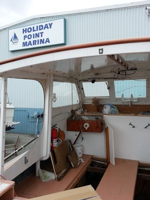

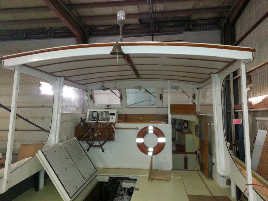

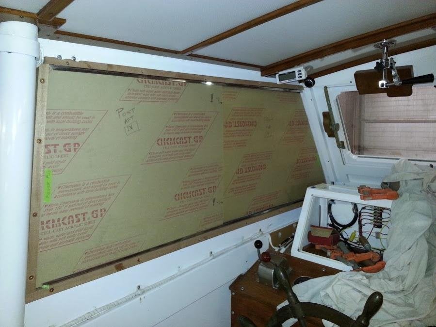

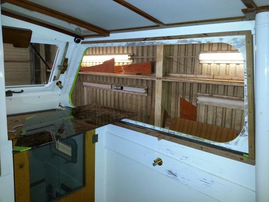

Some more photos of progress to the Dragon Lady. I have asked Mast&Mallet to convert my fixed side side windows to split sliders, they should be done in another week or two with all of the upgrades that I planned before launch next month. The first photo is from this time last year, with the old decks, overhead and helm. Since then I have had the decks replaced and the over head fitted with Soundown. In the following photos I have installed a stereo, new wipers and a new helm station panel with electronics. I had M&M cover up my wiring and wiper motors. I also added a few before an after photos and more details of the total work done since last year in my album.

New deck in the whole cockpit or just up forward? Wood?
Classic details, bronze everywhere and that deck is like the back 40. whats not to love.

The 10ft aft of the pilothouse is the original 1-1/2" T&G fir deck with oak beams, all close grained, 42 years old, all just fine. Hated to redo the forward 8 ft but the hatches there were just too big and heavy for regular maintenance. There were a couple of places that were soft and needed replacement so I just had it all removed and redone for the sake of my old back and knees every time I needed to do a simple check in the engine room. The new deck is 3/4" ply, the hatches have a band of 3/4" solid mahogany with doug fir stiffeners and gutters all around, all of it coated in epoxy and painted. It should see me out.
