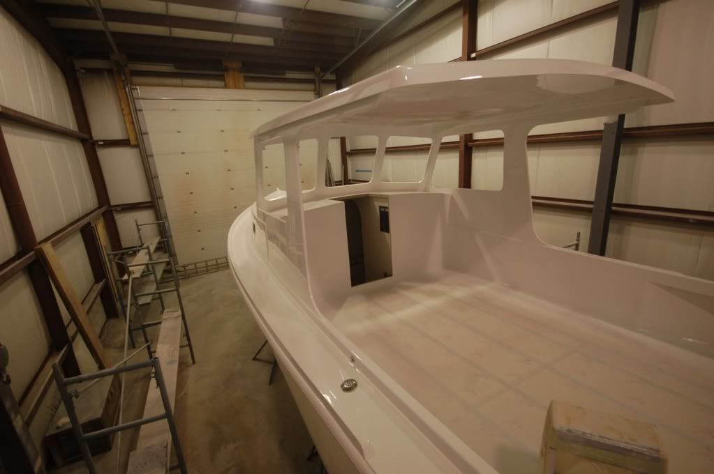

Hello All!
A few Folks from this forum have asked me to post the progress of our 33 Duffy being built at Atlantic Boat in Brooklin Maine...So here we are about half way thru the build. I had originally posted on Noreast.com but will continue here with pictures as well.
The Duffy we're building is based on the 31 hull stretched to 33', we'll keep it light in weight for both speed and economy. After the seatrial we'll move the boat to New Bedford and use the boat for our commute to Cuttyhunk, offshore runs and possibly 6-pack charters.
We'll start with the mosr recent set of of pictures just after the white Awlgrip was applied to the topsides... As "Bill D" says..."For what it's worth"

Thanks for bringing your build progress over to this site. You have the makings of a gorgeous boat there, wishing you the best of luck with her. Looking forward to the updates!

I noticed on the noreast thread that Atlantic boats raised the sheer 3" on your hull. I think the raised sheer makes the boat look better (and tougher). Beautiful boat, keep the pics coming

Been watching the stretch/build tread on Noreast
Not till now did I notice some detail in the 2nd pic you posted here.
Front upper tip of the bow, it has a very similar if not exact ornament shape as do the BHMs.
Don't think I noticed that on other Duffy's.
