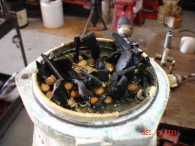

Here's a couple of pics of an aftercooler (a Cummins I believe) that has not been serviced regularly.
Pretty susre it is a FL boat with year round usage.
Notice the fine collection of marine growth and impeller pieces.
Gauranteed this engine had over heating issues!!!!!
Any guesses why?

Bill, to me that looks like the heat exchanger. Hard to believe that unit got that bad before it was checked. On top of that why did they not go get the missing impeller blades when they were changed. That is the kind of stuff that would drive me nuts.
In my last boat I went through the whole cooling system before my first offshore trip and found broken zinc pencils, impeller parts and electrical tape. Nice stuff, and the engine had been serviced on a regular basis. You just never know unless you do it yourself.

that's a garbage can if I ever saw one. The cooling side of the engine is the catastrophic side. Price new engines lately?

John, in fact the pics are the aftercooler.
I'm not sure of the "sea water flow" on the CATs but on a Cummins the sea water flow is as follows.
Raw water pump to:
1. The fuel cooler (nothing really there to pick up impeller pieces) On my engines I eliminated the fuel coolers.
2. Aftercooler (that's where most impeller pieces get lodged)
3. Gear cooler (you can find small pieces of impeller here)
4. Heat exchanger (not much gets to it other than zinc gunk)
5. Exhaust mixer.
There are three pencil zins on a Cummins. Two on the aftercooler and one on the heat exchanger. Sometimes an additional two (like on my engines) on the gear cooler.
The reason an aftercooler like in the pic will cause overheating issues is a lack of raw cooling water to the heat exchanger.
No different than putting your thumb over the end of a garden hose to stop the flow of water.

"Athens' rule of thumb" on aftercooler maintenance EVERY 4 YEARS regardless of engine hours consumed.
Other than keeping the cores clean is to make sure the cores/housing/caps where ALL touch/come together with O rings etc. are
greased preferably with Alco Metalube grease.
This procedure will prevent corrosion of "dissimilar metals" and of course allow your to "get the afterooler apart" every 4 years or so without beating the crap out of the core trying to get it out of the housing.
BTW, if your Cummins (?REMAN?) is out of the boat, used or new, now is a good time to take off the caps, remove core, grease all up and put back together. You'll appreciate the effort when you take it apart a few years down the road.
