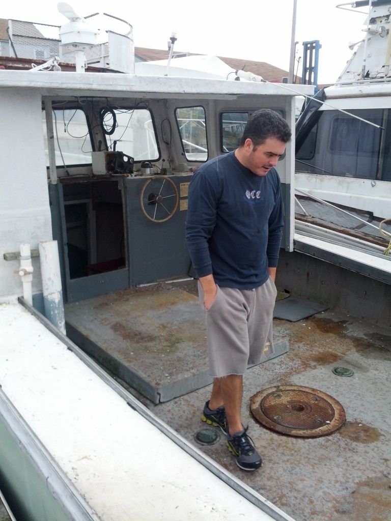

IS IT EVEN A DE? Or is it a deadrise?? Anyone have any experience with these boats? One for sale near me in shit shape but motor seems too run well.....Were they all built solid glass hull? Didnt get pics of the bow....very different

We had one it was an awesome work platform one of the biggest little boats. Try finding a a 28 that has 10,6 at the transom.Definantly not a speed demon but decent on fuel. Ours had a 150 HP Isuzu diesel 8 to 10 knots. Ours was set up to drag. Should be some pics here on site when we had it up for sale.

We had one growing up. Really large 28' boat. It has a bow like a battleship. Not really Carolina, not really Maine. They were built here in Freeport, NY until he went broke. It was a great riding boat. Very stable. It originally had a Bedford diesel. NA 150 hp diesel. It did 10 kts. My dad repowered it with a 250 cummins b. He was told it would do 20 kts. It didn't ever go worth a darn. I think the only way to get 20 kts out of it was to push it off a cliff. LolIt was a great boat other than that.
Guy who boat it made it a 6 pack boat in the Carolina's. it's got a massive cockpit.

The engine might run well but that would mean it is the only system that I can see that does. Nice glass work on the tabs that run over the stringers; wonderful wiring updates; that's a properly installed 8D if I've ever seen one! Clearly, the maintenance school here is to do nothing until "it" stops and this tells me a great deal about lub oil and engine zinc changes and other necessary maintenance. If you'd like some evidence of my concerns, ask the seller to show you a copy of his current insurance premium!
This may be something that you can afford but I wouldn't recommend your wasting even a dime on a proper survey - just run away from this disaster as fast as you can and leave for some starry-eyed dreamer who will rue the day that s/he ever caught sight of this thing.

I looked at that boat a few years ago before the owner passed. As I recall if ou reach under the deck you can feel it going soft. Among the obvious.

no doubt it needs a new deck...it needs everything redone.....The point would be to have a winter project and a beat around wouldnt use it as a primary......Thanks for feedback..
