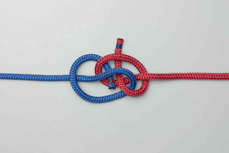

The rule i go by is 20% more buoyline than the depth of the water your fishing in. You could just coil up the extra and use some heavy duty zip ties to keep it coiled or here's a couple of pictures of a sheep shank knot. Also here's a link to see/learn how to tie it http://www.animatedknots.com/photos/sheepshank/sheepshankR8.jpg
When i lobstered back east i made all my buoylines in 10 fathom sections and just lenghtened/shortened as needed.
My version uses a clove hitch to hold each end of the coil, i've used this to hold a coil of 150' of extra buoyline when i end up going a bit shallower than the regular 600+' i fish for shrimp in.
some knots for tying shots of line together
