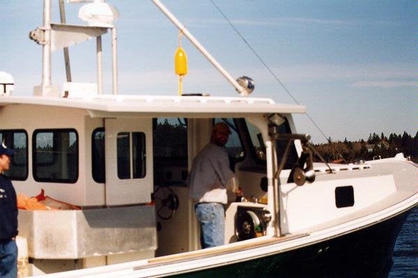

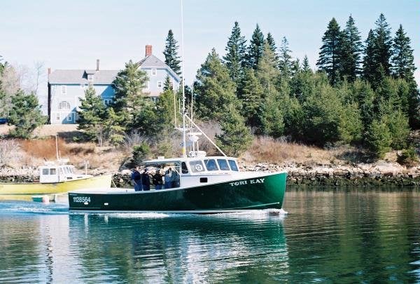

Lowell 43 - Tori Kay
Split wheelhouse fishing boat
740 hp 60 series Detroit
Cruise of about 22 kts at 1800 rpm
Top end of about 26-27 knots
The owner travels 38-43 miles each way for his daily fishing. In his previous 42' boat with a 650 hp Detroit, he used about 110 gallons of fuel per day. With his Lowell 43 with a 740 hp Detroit, he is using 75 gallons per day. The owner also remarked, "I could never fish the days with that boat that I can with this one."[attachment=3:1c3thdr0]64163l.jpg[/attachment:1c3thdr0][attachment=2:1c3thdr0]1937098-R1-015-6l.jpg[/attachment:1c3thdr0][attachment=1:1c3thdr0]1937098-R1-051-24l.jpg[/attachment:1c3thdr0][attachment=0:1c3thdr0]TK-cabindetaill.jpg[/attachment:1c3thdr0]

Does not look like a hull the was pushed out 2 ft?

You cannot push a hull out 2'. These two pics of the 43' Lowell shows the sides of the hull go straight up from the bottom of hull. This is a very large boat. A boat that is 13'3" wide "pushed out" to 15'3" would not look like this. It may be 13'3" wide somewhere on the stern (maybe on the waterline?), but this boat is huge and is an honest 15'+ wide boat. And I would be shocked if they did not take care of their molds. If you are going to spread information that makes a builder look bad, at least provide some proof (like some pictures). If your statements are not true, I think they are somewhat slanderous towards Lowell Bros and you should retract them.

I love the look of this boat and it looks like a real beast but I would be concernd about the running angle and view over the bow, from looking at the pictures. Can you sit in the helm chair and see over the bow or do you have to have to be looking out of the top outboard corner of the window to see what is in front of the boat?
