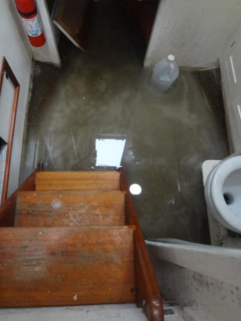

We've cruising Penobscot Bay with Spindrift since 1966. Dad & my uncle bought the bare hull new from Hugo Lehtinen Boatshop (Tenants Harbor, ME) in 1962 and proceded to build the rest. Now it's time to move on to a fiberglass boat with for minimal maintenance (160 hrs each spring with Spindrift which is complicated by living 1 3/4 hrs from storage location) and improved accommodations. We enjoy the semi displacement full keel ride (8.5 knots @ 1750rpm), pilot house with side & aft doors, wide walk around decks and raised bulwarks. Recently looked at 1978 Bruno & Stilman 35' based raised pilot house double cabin cruiser. Problem is the decks forward of cockpit and cabin sides are soaked & rotten. There's actually a football sized hole through the deck. Since she's been left uncovered winters (5th winter) there's water/ice in the bilge up to the stuffing box and 18" deep forward (made me cringe, pls see photo). Anyone know these hulls well enough to know if the hull can stand the punishment? I'm concerned about water soaking into the glass (causing blistering later) and engine bunk stringers as well as stress from ice expansion. My neighbor says run! Thanks for any input is appreciated.

I wouldn't be too worried from just that one picture you tossed up. Sounds like there is a stick built plywood top on it from your description, nothing a saw and some elbow grease can't fix.
Welcome to the site, any other photos of this jewel? I wouldn't be too worried about the fiberglass absorbing water. The ice in the bilge can be a concern but not overly so. That hull comes from the days back when people were still asking "so how thick is she cap?" a hold over from wooden construction. It's a solid glass hull I hope, the core ones had a bad reputation.

Everything forward of the cockpit needs to be replaced (ayah get out the sawzall). I'm mostly concerned about the hull damage, need something worth while to build on. The hull has been painted so hard to tell condition other than sounds solid.

Just from the pics you have posted I would approach that boat as if the whole house and all of the interior needed to go. Maybe it wont but much better to assume the worst than the opposite.
Is the hull cored? Engine must be a block of rust after sitting underwater?
Seems like there might be a better deal out there somewhere to me. Unless you are looking for a serious project. Any chance for an engine pic?

Pictures help a lot. How much of this do you plan to take on yourself and how much will you shop out to professionals? It looks so far that Toolate is correct, you are buying a hull. I also would expect all systems need replacement. I don't know your level of experience so I will ask, did you sound the hull with a hard plastic hammer? Would you know what to look and feel for? You could drop a couple of hundred bucks on a survey to get some professional advice. You will need professional survey results to get insurance or financing.

I did check the hull over, sounded fine and not visual problems (ie cracks, blisters, etc.) Most of the interior would go, new bulkheads, decks, etc. May be able to reuse cabinets and other items that will fit our plan and are not ruined. The engine is one of the best parts, paint's ok and turned with a wrench (water was up to shaft at stuffing box, not up around engine, fortunately).
