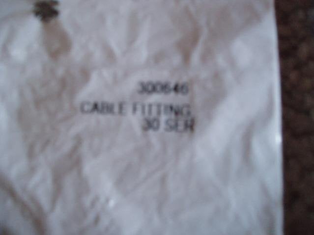

I picked up these cable ends that lay right up against each other flat for my install, i've used them before on my Henriques for the fwd/rev i had from the trans to the stern control.
