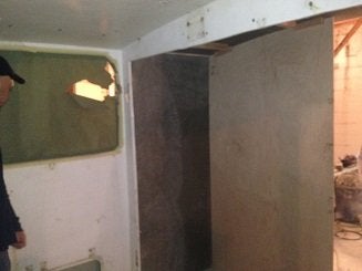

boats always been solid but needed some more comfort so a bigger house was in order we pushed the house back shy of three feet

a few pics below
