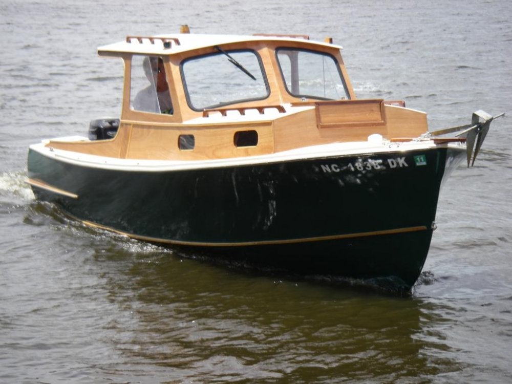

Been a lurker here for some time .I am in the early stages of my first lobster skiff build (or build of any kind) . It is a 20' cold molded plywood boat. It is specd w/ 3/8" okume bulkheads and bottom and 2 layers of 3mm 1/8" okume plywood sides planked in the ashcroft method which is planked diagonally and staggered seams. It is designed w/ a 25 gallon tank below deck and is rated for a 25 to 60 hp outboard. I have attached a pic of what she will look like when done hopefully.

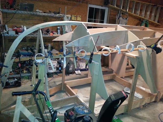

got the side stringers cut and bending into place. Will start side planking soon. 6-5-14a.jpg

No not all bulkheads stay. The one closest to the keel stays. It is where the anchor rope is stored. The next 2 bulkheads are temporary and the stability is replaced with the bunks. I am attaching a pic of the modest cabin. B&B 050.jpg
