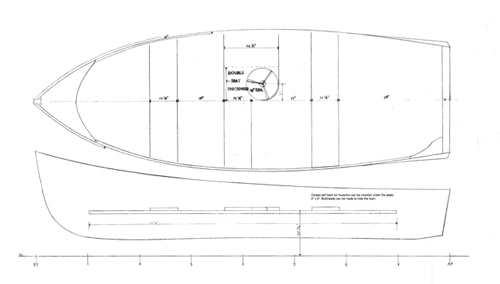

The 16' footer sounds like about what you're looking for
Design by Philip C Bolger Commentary by Mike OBrien - Boat Designs
I think you may have found what I am envisioning. In my research I had explored Bolgers designs as well as Spira, Wellsford and others. For some reason I did not come across the Shivaree. Not surprised though because spending much time today looking for examples or comments from those who might have built the design have been futile.
I will definitely continue searching though. Thank you for sleuthing the Shivaree out!

The offsets tell of a very nice sheer and over eye please craft. This type would lend itself to either lapstrake or cedar strip planking (I maybe speaker heresy here) lapstrake would require bent frames but the strip planked model could have a glass layer in side and out
Yes the sheer is quite pleasing in some photos I found. Seeing it off paper I think she may be designed for more speed than interests me. There is something about the looks of the Northumberland boats that just gets to me and I think would be quite practical for two old folks to use as a water born Willy's Jeep. Beamy, stable and able to carry some load for their size. Great for general exploring, Island hopping and hand lining some cod.
