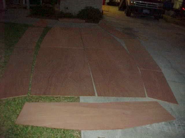

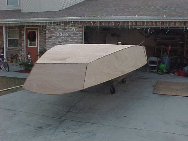

Im having a hard time putting construction methods into words. I guess It would be. Cut pieces of marine plywood or choosen core material to their intended specs. wet them out individually. then start building. bonding them in place, assembling using drilled holes and zip ties. fillet the corners then tab them togather with glass tape. wet out and mat the whole structure.
Im pretty sure that wasnt a good explination but in a nutshell thats it. you basically for go any perminant framing aside from bedded in structural supports. Kind of opposite of how the 47 dixson wheel house was made. Let me see if I can dig up assembly photos my friend took of the boats being built

The cable ties, or metal twists, just get lopped off and smoothed over. If there is some left below the fillet that's fine, because it's already covered up. The fillet will hold the shape while the glass cures.

Wood flour and resin were used in our application. Next one is going to be a piroge for ducking in swamps ;)
