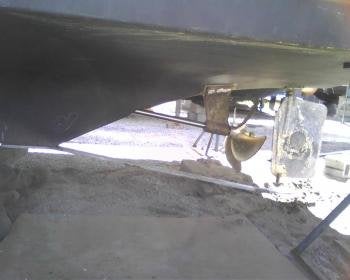

With all the crap floating around after the storm a prop shoe was in order.(also will protect prop if i kiss bottom in gsb)...1 inch thick 316 stainless 3'' wide.Going to weld stainless angle iron on bottom to form a point and will add strength.Also need to make support that will go to strut.Rudder needed a shaft to connect to shoe also.

Nicely done. Any way of tying in the shoe to the strut for some additional support? It looks like a long run.

made a bolt on 3/4 inch thick piece that will weld to shoe and bolt to strut...
