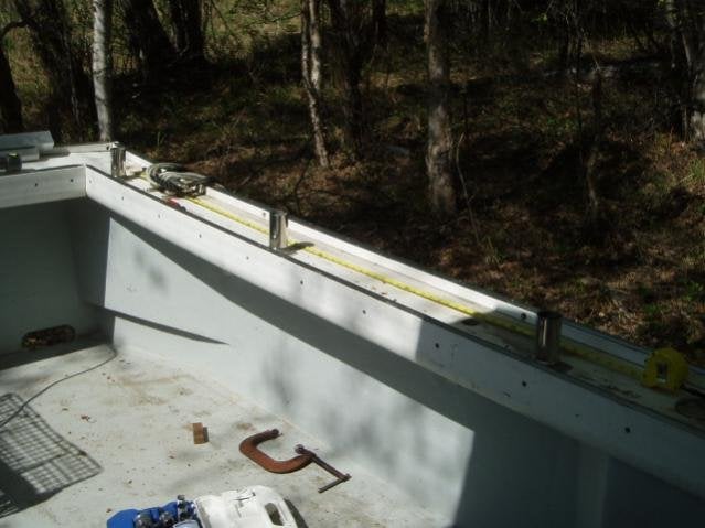

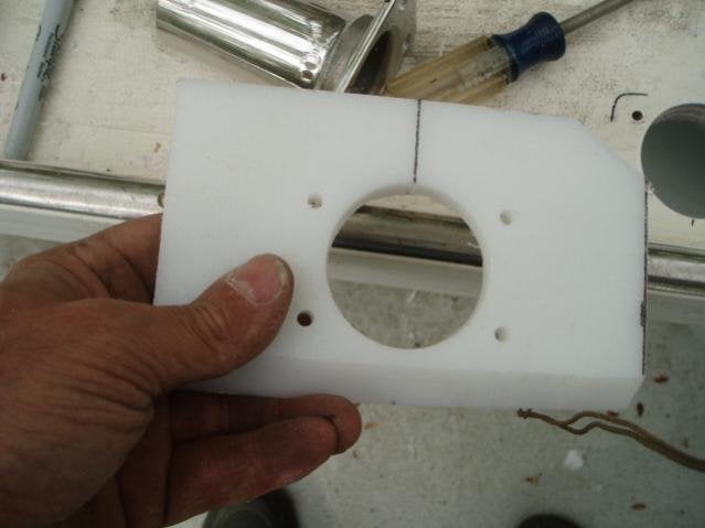

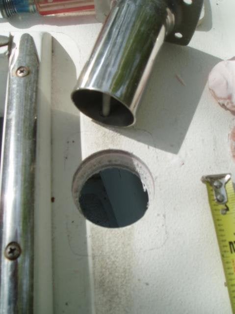

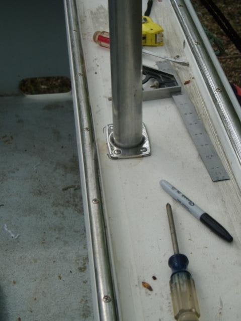

Spent the day planning,measuring and cutting holes in my washboards for a removable trap rack i'm building. I'm using rod holders for the sockets that the rack will plug into. With the way the rear vents are made, glassed in on a diagonal, i had to hold the rod holders over to the inside of the washboards so i could tighten the bolts holding the rod holders. I did get all of it gooped up and bolted in today, i went to the plastic shop the other day and went through his scrap pile to get some 1/2"x4"x24" UHMW to use for backing pads, found 2 nice pieces for $2 i'll use the extra for another project, he's got 3 4'x4' bins full of cut offs and there is another pile of 6-8' lengths that would make great trap runners.
Next up is cutting and drilling holes in aluminum for the rack itself.
6,533
5,026
Got it all fabbed up today, cut the square tubing and the pipe rails, got it all clamped and squared up and its off to my buddies shop to get it squirted together on monday. Just have to figure out a mount for the side of the house.
