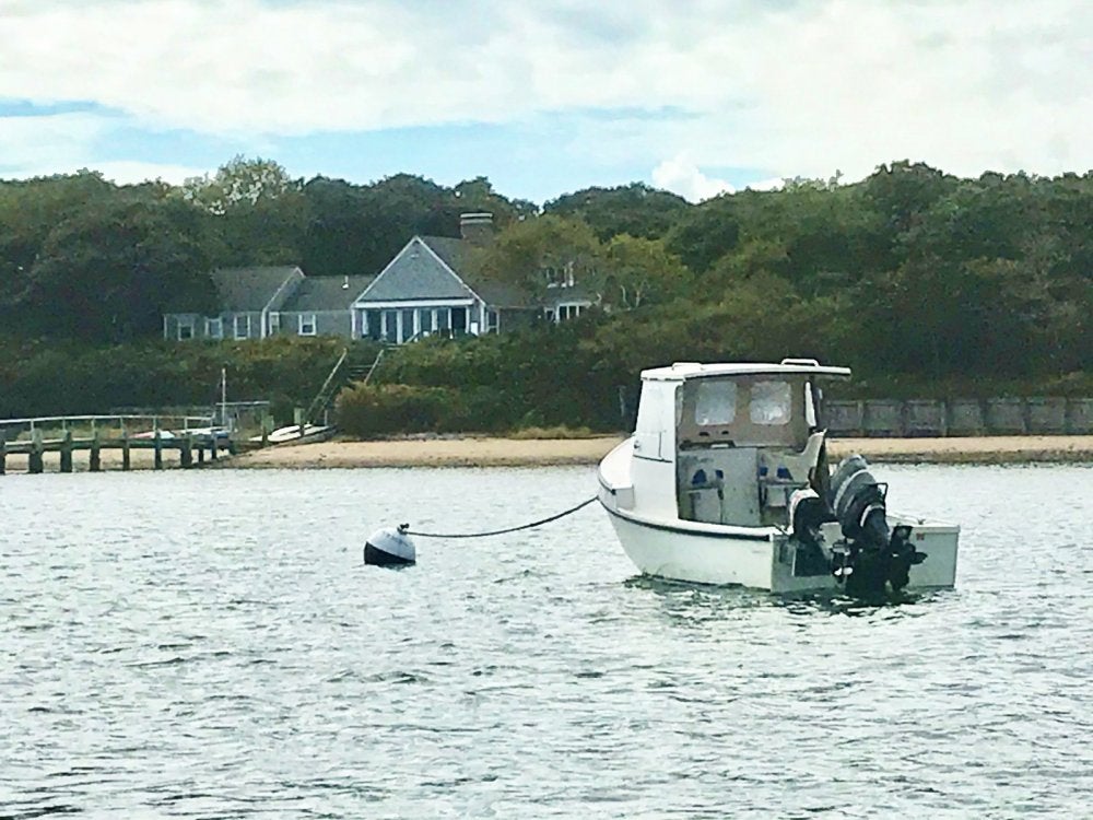

Introducing myself as the new owner of a very used Rosborough RF-18 which I took a gamble on buying in late August and, after extensive cleaning and numerous repairs, replacements and upgrades was finally able to launch and motor from Cotuit on Cape Cod to my Martha's Vineyard home waters this past Sunday. The ancient 90HP Mercury "Tower of Power" did the job but is definitely more power and weight than this hull needs (IMO ;-) I've read the forum threads extensively, and look forward to corresponding with other RF-18 owners as I address multiple improvements ahead of the 2020 season!

Howdy-- I drove up to look at it thinking that if the engine started and went into gear, and the trailer was road-worthy I'd buy it.... had severe second thoughts afterwards as it needs a LOT, but of course has "good bones". The Mercury 90 is too much power, and too much weight on the transom; I just picked up a Yamaha 85 that's 10 years newer and 60 lbs lighter-- hoping that, plus Bennett trim tabs will keep the bow don and minimize "porpoising" (she bounced all the way across from Cotuit on Cape Cod to Edgartown, Martha's Vineyard Looking forward to a winter's worth of work, and mid-spring launch
