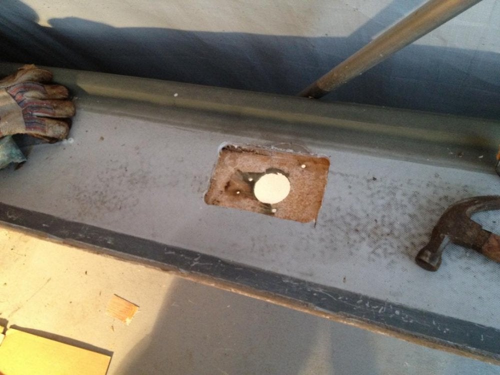

ill jump in with a small project one of many. recoring where the rod holders were poorly installed.
first cut the top layer off get rid of rotted balsa. thats where i stopped yesterday. next grind lower layer and reglass for instalation of new bala.
hopefully i will get to that this weekend, more pictures to follow.remember im just a guy in his driveway! thanks

Have you considered using muliple layers of 1708 and making them solid? they will never rot again. Just a thought.

I would agree with Tuna, lay up a solid panel on a table to close to the thickness you need, then cut it to fit and glass that piece in your spot. Fair it and finish as you like. Will not rot again and be plenty strong.

the boats realy worn i will be doing a roll on nonskid,trying to mach the molded nonskid is realy hard to do, i have done this before and the smaller the repair the eaiser it is, also the boat was a drager so it only had two rod holders. so ill recore and want to add many more, when i install the new ones i will prepare the new holes proper so as the holder is in solid by removing the core and filling around the hole at least an inch in. thanks for the input keep it coming, cant learn anything with out the help of sites like this.

I do it a little different. Once the rod holder is out I place an allen key into a drill. I start by walk a small allen key around the rod holder hole & then to larger allen keys until I get to good core.
Once I have good core I tape and close the bottom of the rod hold. Next I simply pack Hull & deck puddy into the void. It dries like iron. Once it has set up I run the hole saw thru to clean the edges & re-install.
With both the upper & lower layer of glass in place there are no cosmic repairs to worry about.
Hull & Deck Puddy is an amazing product. If not that then the West System is just a s good.

I do it the same way larry does but I use this in the drill. Do the top first so as you work your way down you still have material to run the roller on. Its alot more controlled then the allen key.

gotta be real carefull with balsa - great stuff - strong as hell - but,get it wet - turns to saw dust...
me,i do things a little different,when it comes to working with balsa coring...
i just overbore the hole - with a hole saw-overbore the mounting bolt holes too - small piece of lexan - little wax on it - tape it in place under the gunnel...wet everything with west system first - then mix that west with 403 adhesive additive - fill the holes...let it kick,redrill the correct size...
replacing that coring,you have there...me,i would cut back a little further,till you get really dry balsa - then,cut a piece of marine grade ply to use as a core,in that area...laminate it in place with the same west system,clamp it,let it kick...then,build that area in matting,till it matches the surrounding area...after it's matted and faired,drill the rod holder hole - use west system epoxy to seal the end grain of the ply - job over...
you're gonna refinish the gunnel's,right ? - no sweat now,just run the grinder down everything,get the gel off,roll it out in interprotect barrier coat - let that kick,quick scratch sand/clean up - roll it all out in awlgrip,sprinkle it with grip tex,roll it again,then one last roll...job over ! sit back,admire the nice repair you just did !

made more headway sunday, got to work for a few hours. preped the holes with glass and almost ready to set in the new core. i like using balsa as a core, i find it easy to remove whenever i have to put holes in the boat, to then fill in with solid glass. the important thing is to protect the core. it seems that thay never did on this boat.

got back it. installed core with core bond ,glass it in prep and prime.
