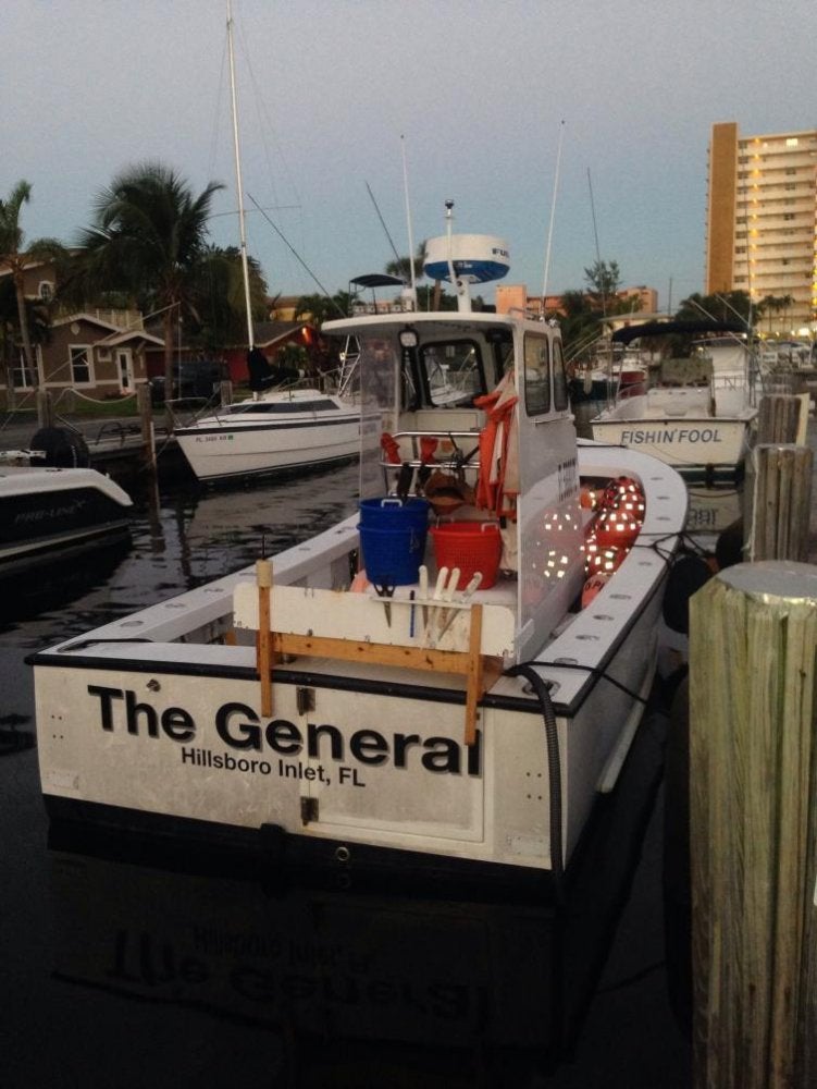

Curious if anyone has done one and/or has some thoughts. It's going to be getting pretty hot down here in south florida next couple months, and I need to get some kind of ventilation in the pilothouse. I know of another commercial boat down here that uses the roof hatch and that's what gave me the idea. It seems like a good idea: minimal spray in house and no weeping windows. I don't have much experience with opening windows, but I have herd that they weep a bit. Often times we are taking solid spray all night. It would be nice not to have that water getting in the house. I am either going to put in opening windows on the side (just the triangular ones), or I am going to do the roof. Any thoughts?
Put in this pic so you can see the pilothouse.
