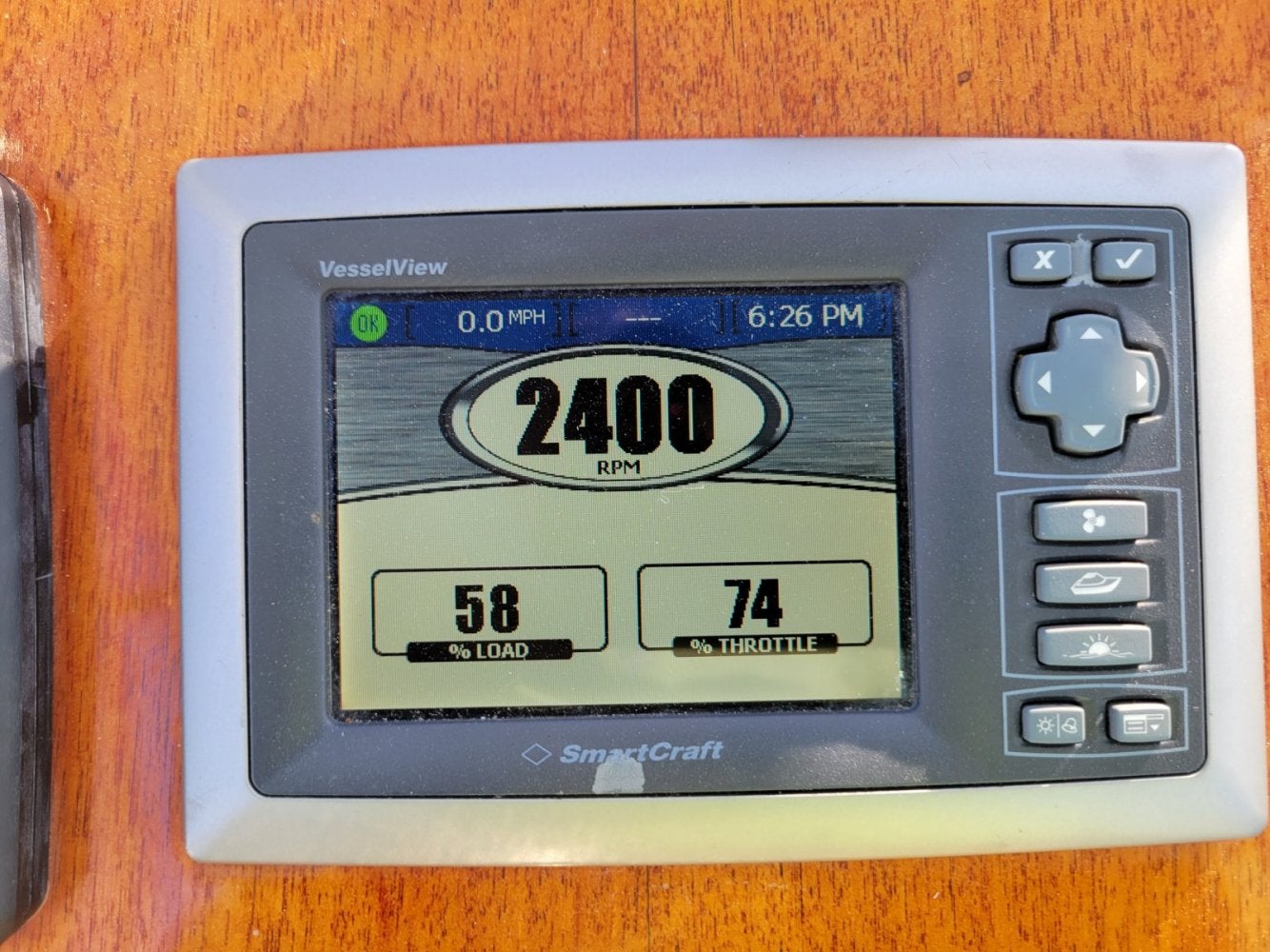

Took out the Sorceress yesterday and here are my numbers, what should I think about these? The engine will spin up to the 3000RPM max power so here I am at 80% of that - 2400RPM, throttle position is at 74% (which I think is in line with the 80% of RPM #'s) and load is at 58%.
Good, Bad, or Ugly?

So you have a 3000 rpm Cummins? What’s the load % at wot? What’s your fuel burn throughout the rpm range versus the factory numbers? Being able to hit your max rpm is good, but we can give you better feedback if we have more details.

Not much info .
answer the following
engine
hp
boat weight
gears
prop
fuel burn at all rpm

Ill have to get back with the fuel burn numbers but I'm pretty sure there are not any at WOT - 3000RPM - I am at 100% throttle and 98% load

Is your boat currently light on fuel, water, and provisions? Adding weight to the boat may push your load numbers to 100% and could cause you to not achieve 3k rpms. If the boat is already loaded to the weight it will be used daily, then 98% load at WOT is perfect. I would use the boat for a while and see if you can consistently hit 3k rpms, if you can, then you have the correct prop.

I am fully loaded with the exception of about 100 gallons of fuel, everything else is on the boat and water tank is full, so I would say its where it "normally" would be run. It gets to 3,000 to 3,050 RPM fairly easily so I think I'm good on that metric, I was just surprised to see at 80% throttle/RPM that the load was as low as it shows. Ill get the Fuel consumption and GPS speeds in the next day or two and post for everyone's comments and evaluation.

Just to clarify my GPS comment- you can connect your GPS signal to the Cummins Smartcraft system and get miles per gallon displayed on the Smartcraft readout. Lots of people have issues with the Smartcraft components, but when they are working they do tend spit out useful info.

Those numbers look good. I would start planning the fun times you have been imaging.

Those numbers look great to me. I have a QSB 5.9 but its 305 HP, rated at 2,600 rpm's. Load is impacted by lots of factors: hull shape, weight placement, the angle of the boat from bow to stern. Ass stuck down low can drive up the load %, or if she gets up on a plane a bit thats going to lessen it.
