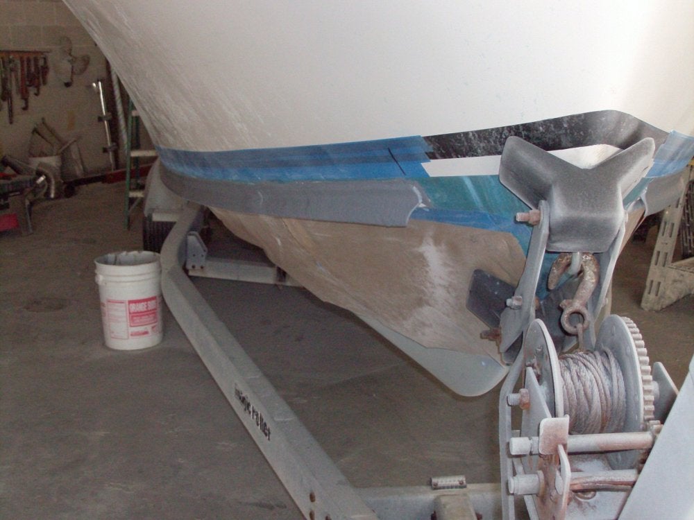

i made a mold to produce spray rails - made out of fiberglass - these,i laminate to the hull - no cheap tape,glue,or screws - these are integral with the hull - unbreakable !
i highly recomend these - fall's here:staying warm,means,staying dry - these WILL keep you dry..
[attachment=2:18535a2g]001.JPG[/attachment:18535a2g]
[attachment=1:18535a2g]002.JPG[/attachment:18535a2g]
[attachment=0:18535a2g]007.JPG[/attachment:18535a2g]

Interesting concept! Are you looking to sell them or get a patent? Do you use epoxy or polyester resin to attach? Is the plug for this mold from another type of rail? Curious
i don't offer these for sale - these are for installation at my shop only
i didn't "lift" a mold from an eixisting product - i made my own plug...what you're seeing here,it's the finished product - except for the antifouling paint.i make these with epoxy based resin

Nice job- I bet they knock the spray down well. What are the dimensions?
