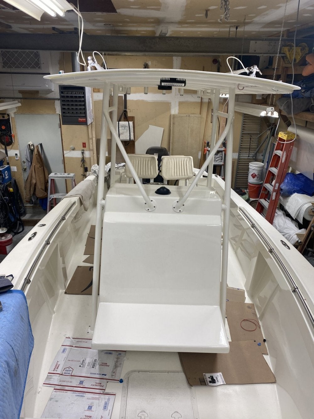

My family has had 7 seacrafts over the years that we’ve redone. None were inboards but they say the inboard rides the best. Maintenance is an issue as stated above. You can’t find a better riding boat in its class as far as I’m concerned. But they are small with a 8’ beam. This is what my father did to the one he has now with that console.
