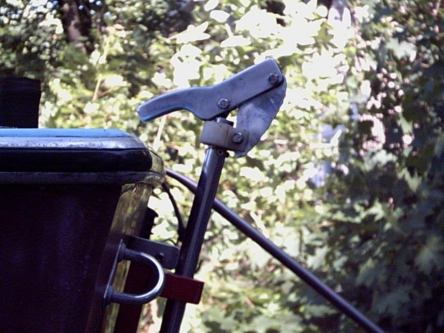

makmak
Jul 8, 2012
8
thanks for the suggestions. Ended up bedding with 5200 and screwing the transducer on. Looks good, not ghetto!
