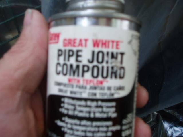

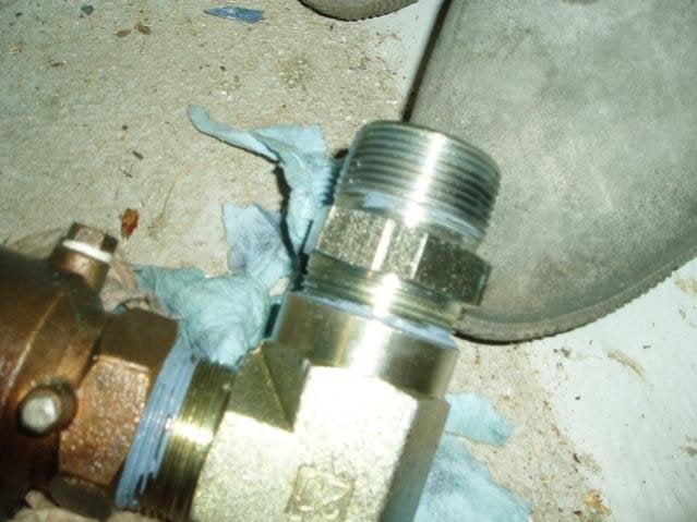

The fitting on the bottom(suction) line of my hydraulic tank has been weeping since i bought the boat last year, i tried tightening it a bit but it didn't help. I took it all apart yesterday now to put it back together do i used teflon tape or white pipe dope to seal up the threads. I've heard that tape isn't good for hydro pumps and motors. The fittings had a blue colored dope on them. I only want to do this once and be done with it, its too much of a pita to drain all the fluid and take all the connections apart, not to mention the mess of the dripping fluid on my engine !!

Use liquid, not knowing what flavor you had on previously I am still surprised it was weeping. The stuff I use is Blue Magic
And it works fantastic, never have had an issue with it. Looks like the blue stuff that was on there, but I'm guessing it is from another manufacturer. The white stuff works well in a pinch. Check for pinholes in the weld too while your fitting is out. A can of brakleen
and a nice rag should clean it up for inspection. If you do have a pinhole or more of them maybe a nice etching primer for aluminum and then some enamel around the weld would work well in addition to your thread compound.

Travis the leak was sneaking out from under and running down the threads of the nipple/elbow that goes into the bottom of the tank, in fact it was coming from under a glob of the blue stuff. I'll clean it up good this morning and use the white stuff i have. Thanks again guys for your help.

Went to local hydraulics shop and asked for the blue magic stuff, all i got was blank faces never heard of it??? so they tried to sell me some Loctite stuff in a little red tube for a mere 38.00, no thanks sez i and went home and gooped it back together with the white stuff i already have and will let it set up overnight before i fill the tank again. Hope it didn't make a mistake by not buying the red tube:rolleyes:
