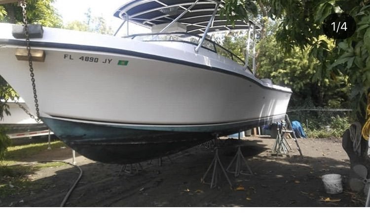

Then I saw a pic online of this guy who puts the boat on stands in the back and then has a huge gantry with a chain fall and he just puts the chain through the bow eye with some blocks so it doesn’t hit the boat and lifts it up and pulls the trailer out.. simple..

Two gantries that straddle the boat. Recently rolled the 23' DE hull over with the same gantries.
