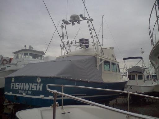

I got 2 projects to complete on my 36 NB before march. One is new fuel tanks. Had a sweet winter cover made so I can work under it. The old tanks were glass and the finisher of the hull before I bought it never put drains from the cockpit bildge to the engine room bildge, so ice must have built up and cracked both tanks. After 3 years of trying to figure out where the fuel was coming from(only happened on long trips when it was rough out) I have decided to replace the tanks. So new aluminum tanks have been bent up and welding starts monday. 2nd project for this boat is an anchor tree if I have the time.
Then I got a 22ft Sisu that needs decks, paint, little motor work and alot of rigging. So it should be a productive winter.....

That picture is a few days old, the tanks have been cut out and mock up tanks were put in place. I believe the bottom of the tanks is where the leak came from. I'm guessing when the boat twisted a little when it was rough out the hairline crack would seperate a bit and let fuel out?

Hi Tuna,
I like the cockpit cover on your new boat. How is the cover fastened to the bridge and rub rail. i am trying to figure out a way to avoid shrink wraping the entire boat every year. My boat has fly bridge with hard top so I have extra issue of keeping instruments in the bridge dry. There are no forwad windows and side windows are fixed so water is not an issue.
I am tyring to find a way without adding a lot of snaps to stern

The bridge has a seperate cover that I hade made 2 years ago. The cockpit cover has a few snaps under the roof and 2 on each side. Then all the snaps for the side of the cockpit are on the under side of the rub rail so you don't see them and the stern ties off to my flat line clips. Originally i had it tied from one side to the other but was worried it would destroy the hull sides so aded the snaps.

With the sun coming in the pilot house windows acts like a heater and its hot as hell under the cover during the day. I'm sure that will change with the weather but I should have the decks back in in another 2 weeks. Not gonna try to fair anything out or paint untill the spring. I'll hold 182.5 gallons per side when done, thats 20 more per side then I had so I'm happy with that.
