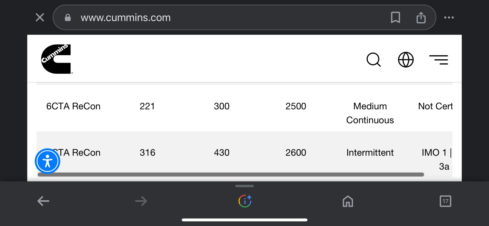

QSL9 405 HP 2100 max rpm
QSC8.3 depends on duty rating. Recreational is 2600/493 hp and 3000/543 and 593. Commercial and light duty is 2600/493 hp and below 2800/530hp and above.
According to the Cummins website via google search...... just saying.
2600 to 2650 on the 430 8.3 6cta seems to be the max RPMs I am looking for. Does that sound right?
