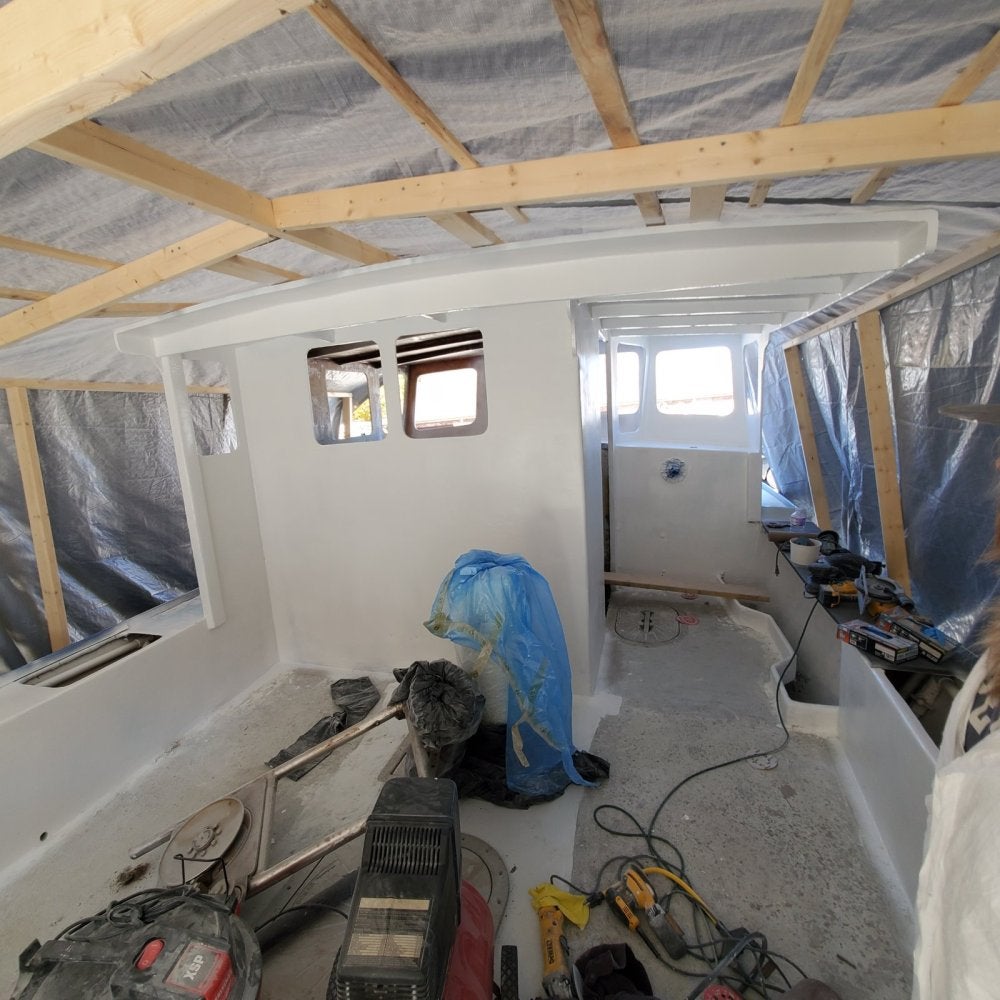

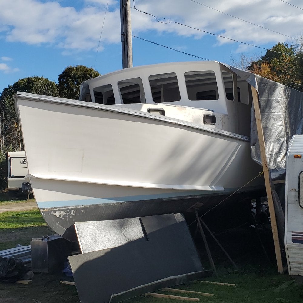

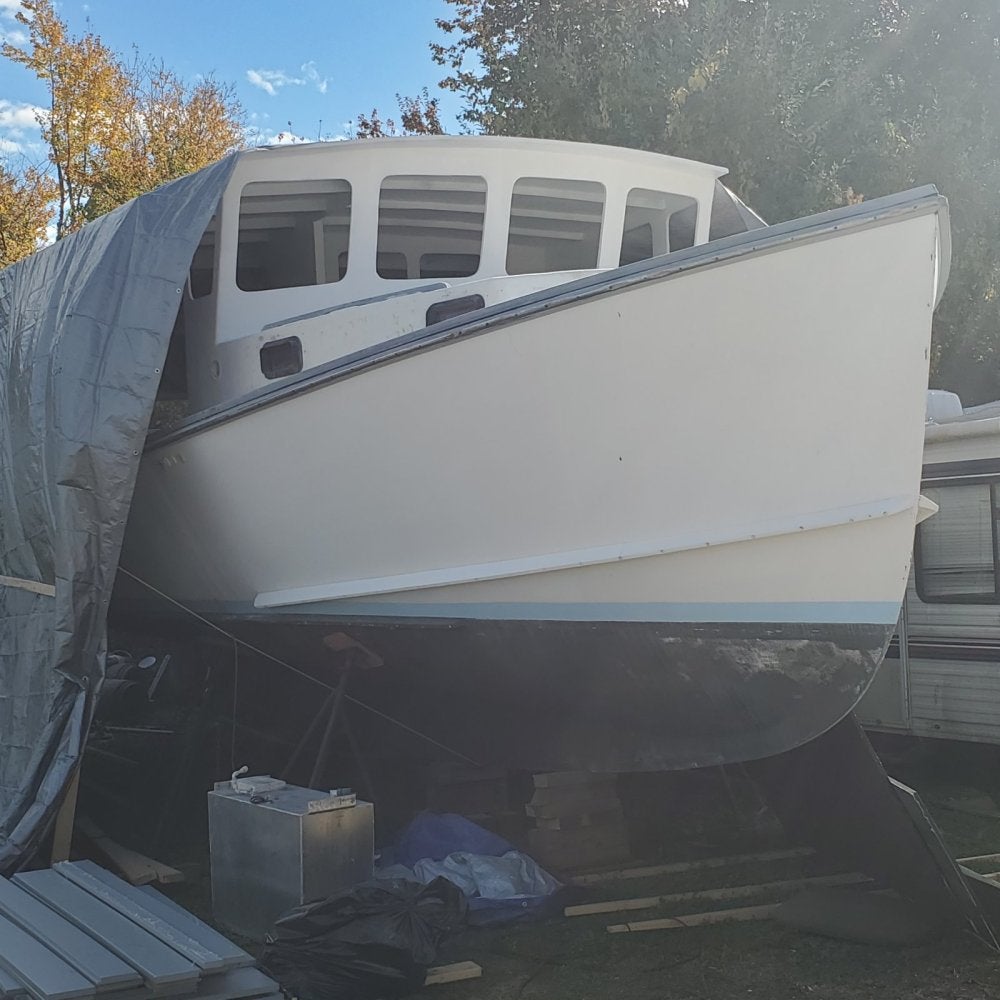

Hello I am in the process of rebuilding a 38 libby. I am dropping power in next week and need to prop the boat. Motor is a cummins 8.3 6cta with a TD 507 2:1 gear. I need to order the prop and i am considering a 4 blade 26 x 26 prop with mod cup. Any advice on prop size would be greatly appreciated before I place the order.

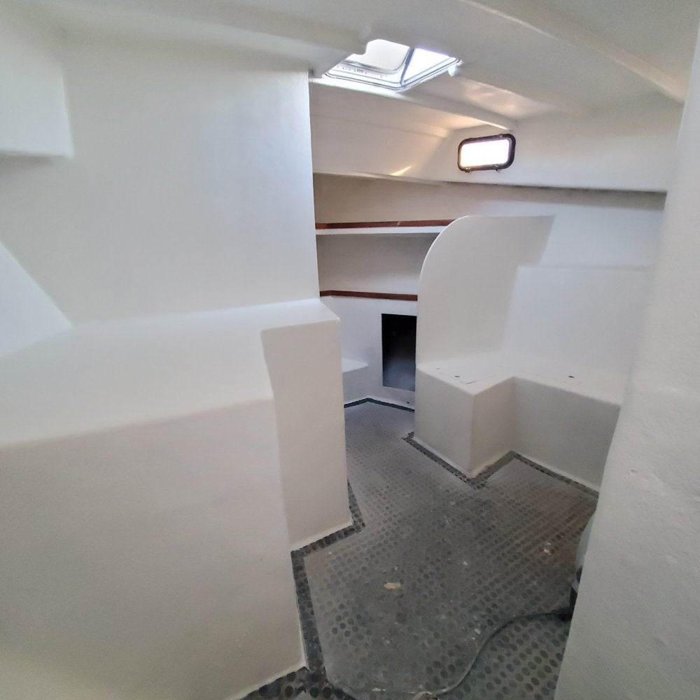

I am keeping the hull light but I carry 8 passengers and gear daily. House is honey comb and all other build out is Cosa board.
Thanks Dave

Looks awesome. Wish I could help on the prop but there are better resources on that subject around here than I. I’d love to see/hear more about your project though. What did you add/change, why, gelcoat or paint, etc. We love boat build stuff around here. I’m sure someone will give you some thoughts on propping.

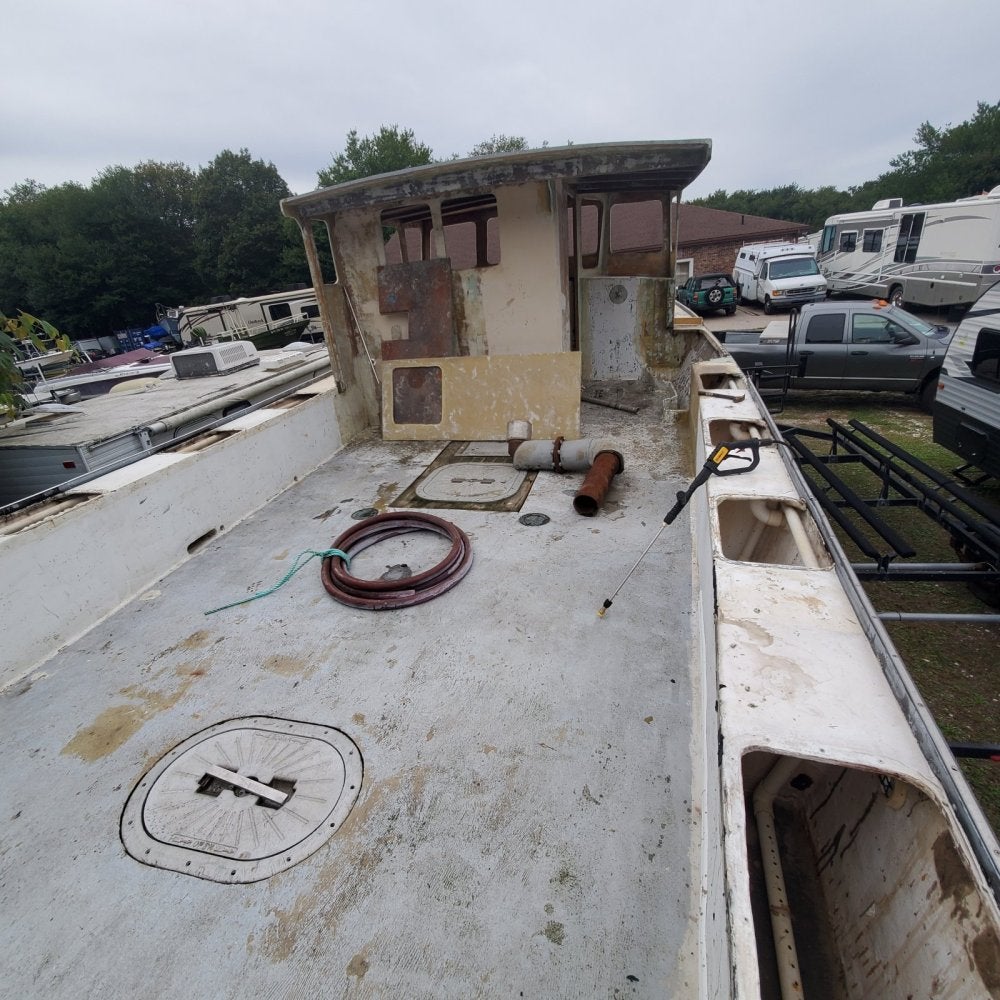

Looks great. What do you use the boat for? Curious about the wells in the rails. Is that a big rope locker by the hauling station?

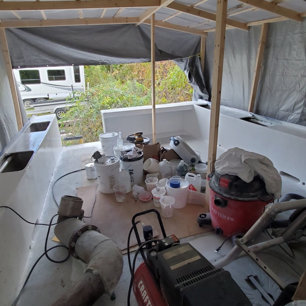

Thank you! She's getting there . I tend to use gelcoat mostly to make repairs easier down the road . The gel on it i sprayed 4 coats of non waxed and the last coat with wax. Cheap purple spray gun from harbor freight bored out to 1.8mm

It's a retired lobster boat and the boxes on the sides are old school lobster tanks . Was going to cut them out but decided to use them for live wells and storage wells . They are plumbed so you can feed water to each tank individually.
The well on the side is a rope locker . Likely holds 1000 feet of. 5/8. I decided to keep it for the anchor. I can always cut it out next year if I don't like it .
It will be used for rod and reel as well as spearfishing charter .

Was this Norbert's old boat?

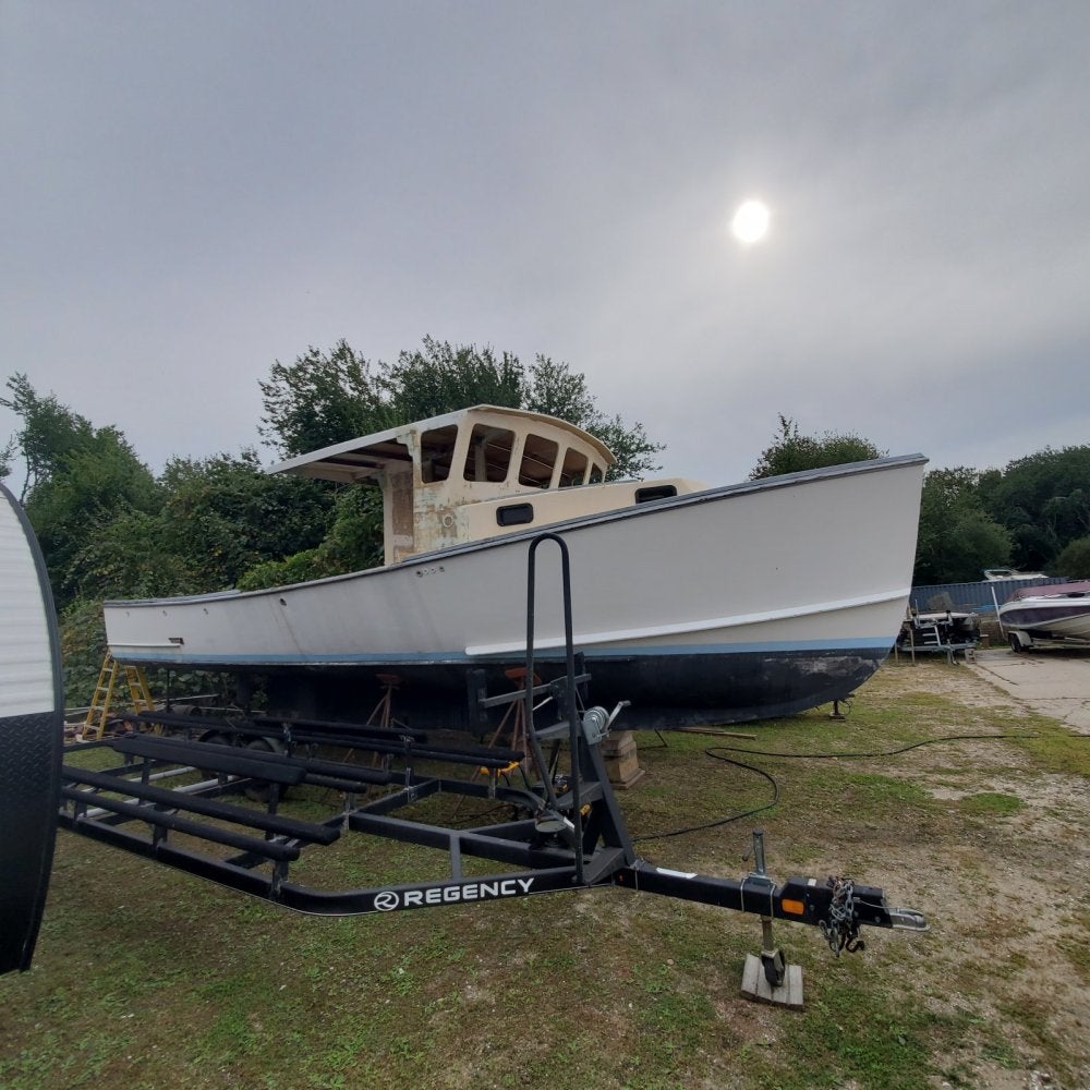

IMO the 38’ Libby sails quite well and worth the time. Looks great…as far as the prop…call nautilus or HH or anyone close…I like to support local. They will have other 38’ Libby’s to reference.
